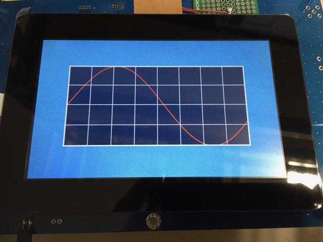

Hello!
Im looking for the best approach to draw graphics.
Here is what I did: I have a signal (I made a sine wave for simplicity but it can
be anything else). I want to draw it with line segments, so what I'm using is
BEGIN LINES and then for each segment, I enter its 2 extremity points.
See picture.
The problem is that it takes huge amounts of data, because I enter every point
twice. This means that for an array of 640 values, I need to draw 640 segments,
each of which need 2 points which is 4 coordinates of 2 bytes each.
5K bytes only for one curve. And if I need an oscilloscope-like display with n curves,
then I have to multiply everything by n, and I don't even know if it's possible to have
so many drawing instructions due to FT815's internal buffer limitation.
Is there a kind of graphic mode that can make things a little bit easier?
For example a kind of LineTo function, that starts from current point and goes
to the next one?
What would be the best strategy for drawing graphics?
Thanks for any hint!
R.

Why not use LINE_STRIP ? then you would just need to pass the coordinates of each vertex and the EVE engine would join them up, ie 4 bytes per point.
But, OPs example involves a continuous curve, which requires a LOT of points to be sent. This gets expensive fast.

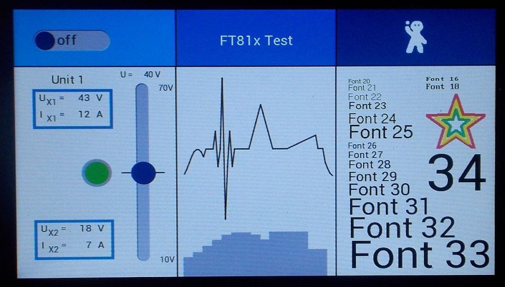

Well, with a line-strip, and I was to suggest the same, this is only half of what the OP calculated.
640 segments are 641 coordinates or 2560 bytes for one curve.
The next step would be to reduce the resolution, using half the points does not make much of a difference.
The "curve" in the attached images is using a line-strip with 64 points.

Hello everybody!
Thanks for all your replies, sorry for the delay.
Mostly because I didn't know about its existence. Yes, apparently line strip is the way to go for me.
Drawing directly to RAM would be (I think) more expensive because I have to draw segments,
not points. For the above sine wave, it's almost the same because the sine slope is limited, but
in case there are some almost vertical parts, then I will have to draw segments pixel by pixel
between 2 points. Therefore I would need to transmit a lot of data, in most cases more than
with the line strip method. And beside this, if I want to write 2 non-contiguous pixels, I think I
would have to transmit them with one 32-bit address each, which would quite eat resources.
Anyway, thanks for your comments!
R
Update: It took me about 5 minutes to modify the code, from standing start. Plug the emulation
probe, start the IDE, modify the code (from LINES to LINE_STRIP), compile, run. Many thanks!
