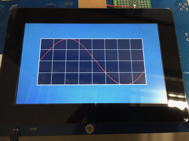

Im looking for the best approach to draw graphics.
Here is what I did: I have a signal (I made a sine wave for simplicity but it can
be anything else). I want to draw it with line segments, so what I'm using is
BEGIN LINES and then for each segment, I enter its 2 extremity points.
See picture.
The problem is that it takes huge amounts of data, because I enter every point
twice. This means that for an array of 640 values, I need to draw 640 segments,
each of which need 2 points which is 4 coordinates of 2 bytes each.
5K bytes only for one curve. And if I need an oscilloscope-like display with n curves,
then I have to multiply everything by n, and I don't even know if it's possible to have
so many drawing instructions due to FT815's internal buffer limitation.
Is there a kind of graphic mode that can make things a little bit easier?
For example a kind of LineTo function, that starts from current point and goes
to the next one?
What would be the best strategy for drawing graphics?
Thanks for any hint!
R.
Drawing strategy.

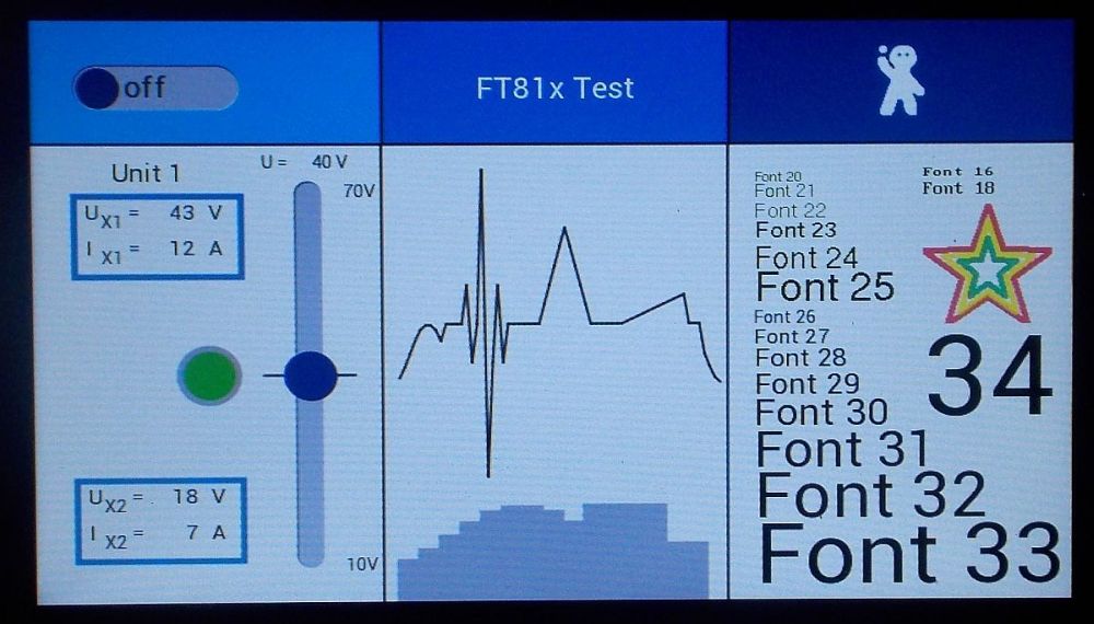

Well, with a line-strip, and I was to suggest the same, this is only half of what the OP calculated.But, OPs example involves a continuous curve, which requires a LOT of points to be sent. This gets expensive fast.
640 segments are 641 coordinates or 2560 bytes for one curve.
The next step would be to reduce the resolution, using half the points does not make much of a difference.
The "curve" in the attached images is using a line-strip with 64 points.
There is annother issue though, VERTEX2F is a badly designed command that can take a lot of time to process.
Shifting the coordinates into position is the issue.
Using a pre-calculated array of 32 bit values with 0b01xx xxxx xxxx xxxx 0000 0000 0000 0000 would speed things up by a lot.
Note that bit 15 actually is bit 0 of the x-coordinate, setting this bit to a fixed '0' allows a much simpler copy/paste operation:
pixel_array[counter] = (x_array[counter] & 0xfff000) | y_array[counter];
The compiler should not even bother to mask out the lower 16 bit and only write the y-word directly.
With VERTEX_FORMAT set to 1 this still could be used for every x-pixel but the y-coordinate would need to be multiplied by 2.
