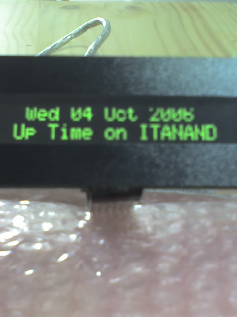

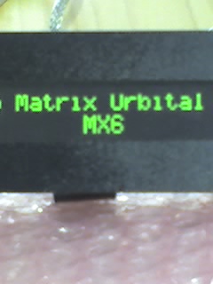

My MX 610 [LK202-24-USB] PCB Rev:1.6 which i had brought from Performance-PCs around 6 mths back was working fine.But now the top portion of the text is missing[see attachment].I tried uninstalling and reinstalling and also on my second computer but the problem is still there.I contacted Hank at performance-pcs,who redirected me here.
Any help/advice would be greatly appreicated.
Photo 1
Photo 1
Photo 2
Photo 2
Photo 3
Photo 3

Thank you for your quick response.I was able to solve the problem by applying a little pressure to the rubber beading around the display and now the display is working fine.I do not know what the problem was,maybe some loose contact.Anyway if the problem persists i will surely contact you for warranty support.
Thanks once again :D

I had a similar issue with my MX610, but I was able to fix it by wedging some folded thick paper between the faceplate and the display package near the zebra strip.
