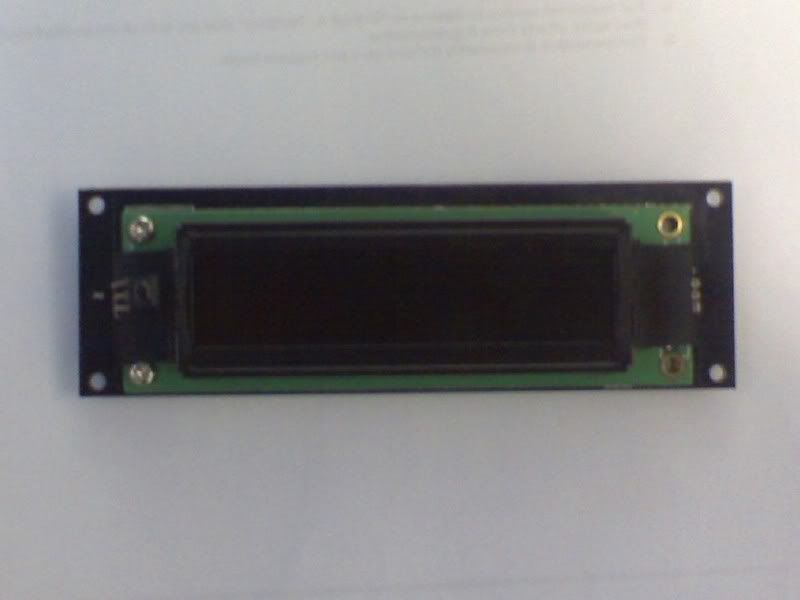

The display itself has a small light green board on a lager dartk green board.
The small board is 4.5 X 1.5 inches.
The back of it has a white sticker that has the following ABC020002G05-DLW-R and underneath that is 050531 to the right of the sticker 0804 is printed directly on the board itself.
The large board is approximately 5.5 X 1.75 inches.
Printed on the board is VFD DISPALY REV A:0 (That is not a typo -it's "DISPALY")
I looked through the Commercial section but didn't see what I had in my hand. I was pretty thorough, but I admit that I did not browse every image.
Here are pictures of the display.
http://i129.photobucket.com/albums/p212 ... /front.jpg
http://i129.photobucket.com/albums/p212 ... e/Back.jpg
Give me a day or so to reach the person that gave me the case and I will find out. (They are out of town.)Henry wrote:I can say 100% certain that this is NOT one of our displays and thus we cannot help you, but this does raise a number of other concerns, one of which being that there is someone in Asia using our name.
The manual specifically says to select 'Matrix Orbital Displays" -there is no copyright information or anything on the manual.
And when the display goes black you can faintly read:
**Matrix Orbital**
!!9600 BPS Serial!!
I believe you when you say the device is not one of yours, but the whole situation is odd.
