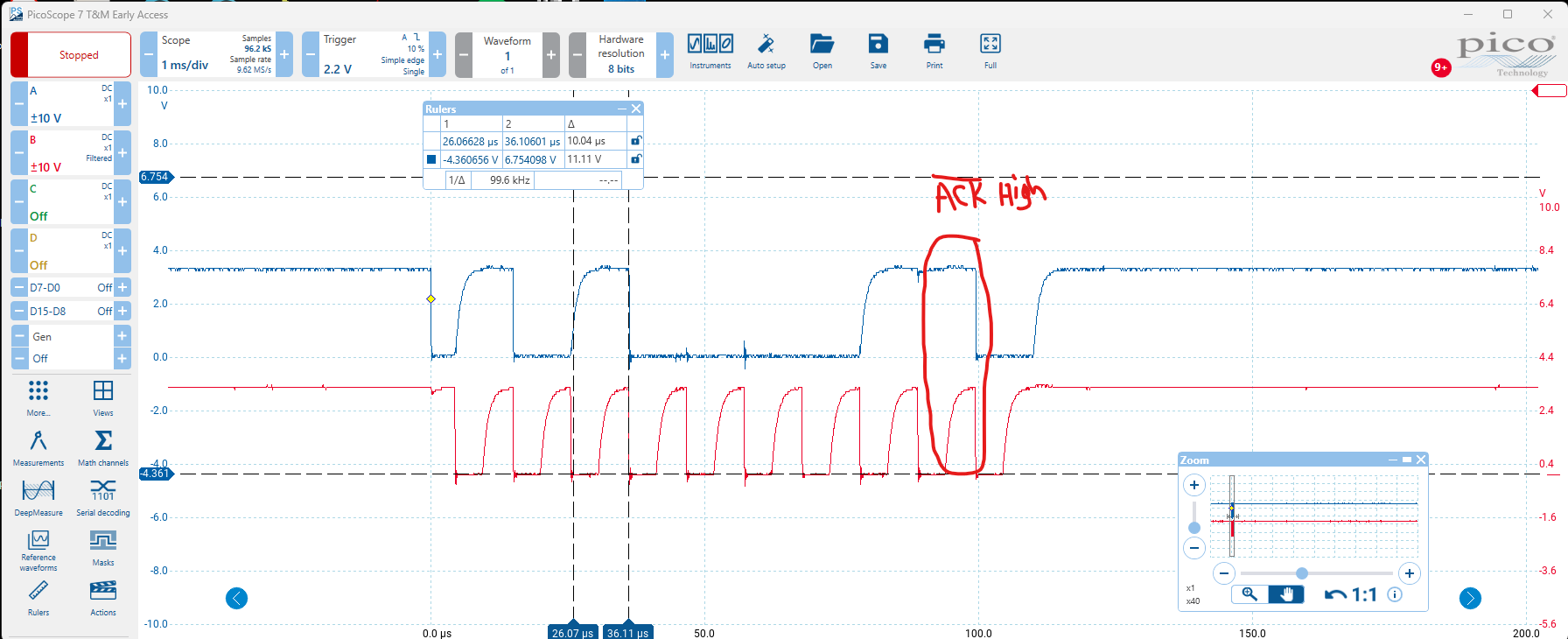

I tried using the I2C interface and didn't receive an ack bit (asserted low) as I would have expected when doing a read or a write request. I have attached a screen shot of SDA and SCL lines during this transaction. As you can see, the ACK bit stays high and the display never pulls it low. The data rate is 100kbps per the spec and the pull-up resistances I used are both 6.8k to 3.3V.

It looks like you are addressing the GTT70A with 0xA0. Can you please try 0x50?

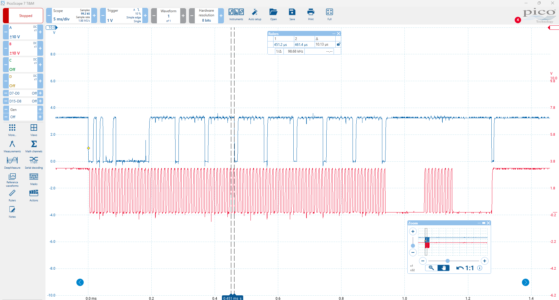

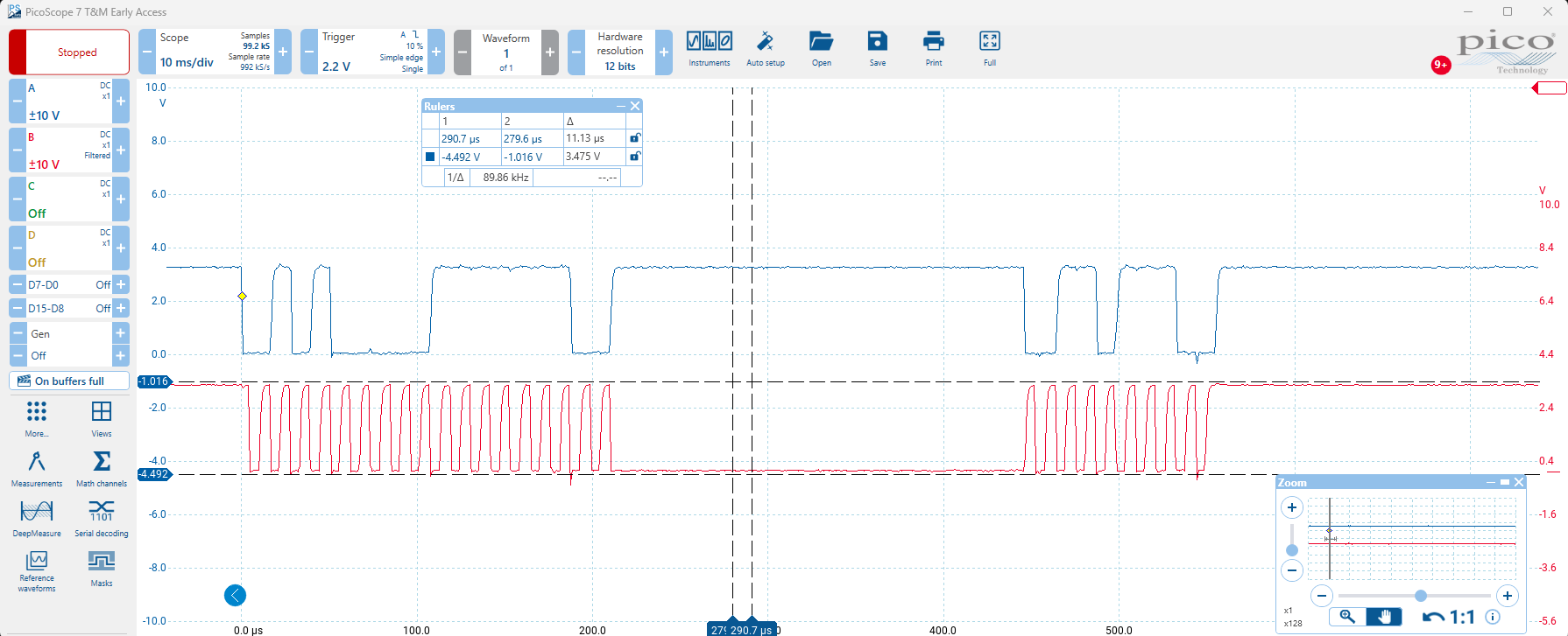

The second command has a corresponding screen shot shown below. I looked out in time as far as 500ms past the end of the command and there was no reply or bus assertion of any kind by the module. I even switched to using 4.7k pull ups to make the edges faster. I tweaked the SDA hold time to make sure SCL deasserted more than 500ns before SDA deasserted, but this too didn't seem to have an effect. See attachment.

In order to get the GTT70A to reply via I2C, you will need to set the communication channel to I2C.
You may please check command 254 5 from the manual.
With I2C, all communication transactions are master initiated.
To read back replies from query commands such as 254 0 and 254 55, you will need to start a read transaction (after sending the query command) with the read address 0x51, followed by sets of clock cycles to get the reply from the display.

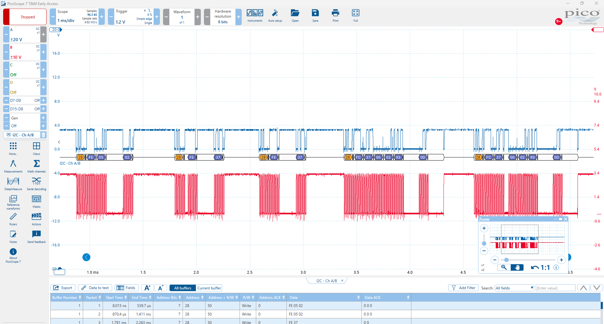

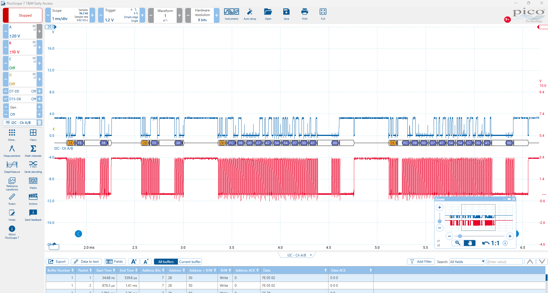

I am having difficulty with my I2C master interface getting it to respond for a read operation after reading your last post and attempting to follow it carefully.
1. I can set the communications channel to I2C with 254 5 2 as you pointed out and get an ACK.
2. I can follow this up with a write scratchpad command {254, 204, 10, 10, 1, 2, 3, 4, 5, 6, 7, 8, 9, 10} which I intend to write 10 bytes to offset index 10 and get an ack.
3. I can then send a read scratchpad command {254, 205, 10, 10} and get an ack.
4. I can then follow this with a read command by sending the slave address and followed by 10 SCL cycle bursts of 8 bits on the bus and get 0 255 255 255 255 255 255 255 255 255 returned from the slave.
Here is a response picture showing the final read command.
I should note that I am releasing the bus between every step listed above with SCL and SDA asserted high, but thought that maybe I should be doing a "Repeated Start" operation at some point in the sequence, maybe between steps 3 and 4 so that the bus is not de-asserted then, but that wasn't successful either. Here is a link to an App note from TI describing Rpeated Start protocol. https://www.ti.com/lit/an/slva704/slva704.pdf

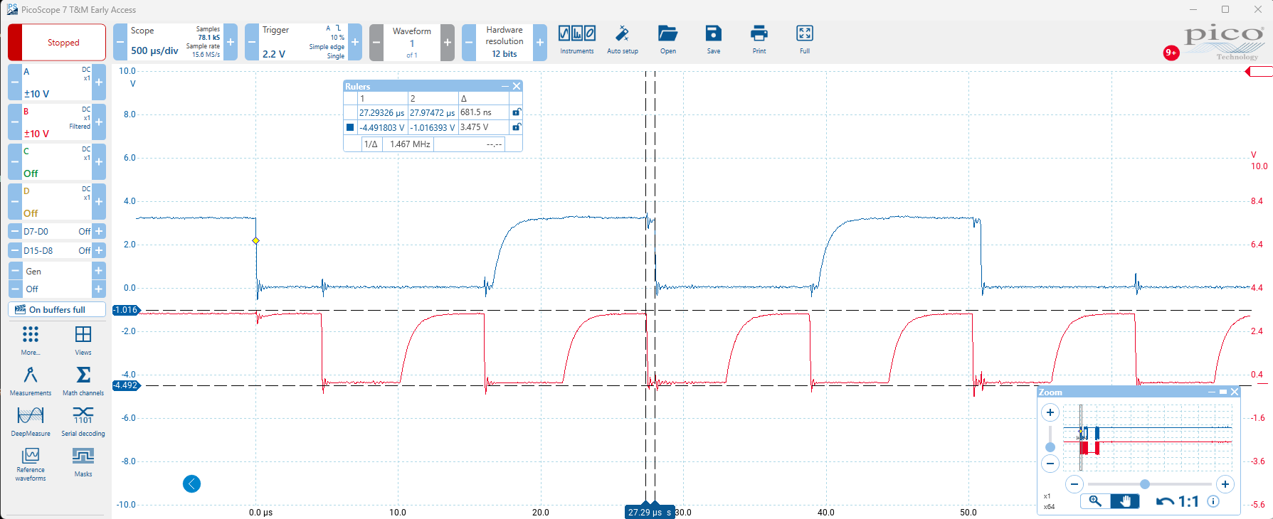

Success! I was able to use the I2C bus decoding feature of my oscilloscope software to decode quickly and concisely the transactions going on and I have it mostly working....well enough I guess. This plot shows the {254, 55} command to fetch the module ID. I thought it should be 37636 decimal which converts to 0x9304 but it seems that what I read was 0x930D, which seems to be slightly different than what revision 2.7.1 of the GTT70A protocol manual states.
Also, I was able to read out the Module ID string as shown here as "GTT70A" after converting the hex to ASCII.
I was wondering though what the purpose of the <00> byte is in the return string of <28> <FC> <37> <00> <02> <93> <0D>. Is this just the most significant byte of a two-byte length field?
Thanks again for your help.
Also, because I am using low level drivers specifically designed for the I2C hardware interface soft-IP block in my FPGA, I am kind of locked in and have to adapt my code to talk to that block, or write my own I2C interface in VHDL and custom drivers, which I didn't really want to get into at this point. So I am happy with what I have going on right now.

Please check Return Message for command 254 55 in the manual.
37645 is the correct module number for the GTT70A-TPC
37636 is for the TPR model; sorry the manual only lists the TPR models
