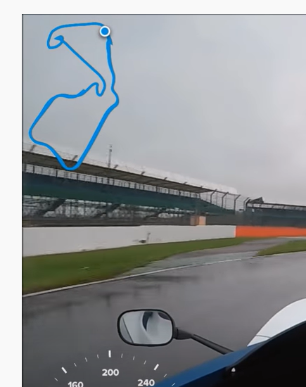

2. I am charting x,y Cartesian coordinates from Latitude and Longitude from GPS. So I can plot a path like the GoPro does. Starting at 0,0. This matters as you will see my question below.

5. For the path chart, is there a way to have the 0 be at the center? Meaning also have the x-axis have negative numbers? Stating at 0,0, if you go in one direction, you would go negative. Can I plot negative numbers? Or do I need to normalize on the host again and only plot positive x numbers? I would want to adjust min and max for both x and y axis as I drive. Or better yet, remove all axis and just have the data points.
Like the attached.
