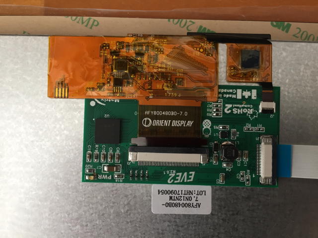

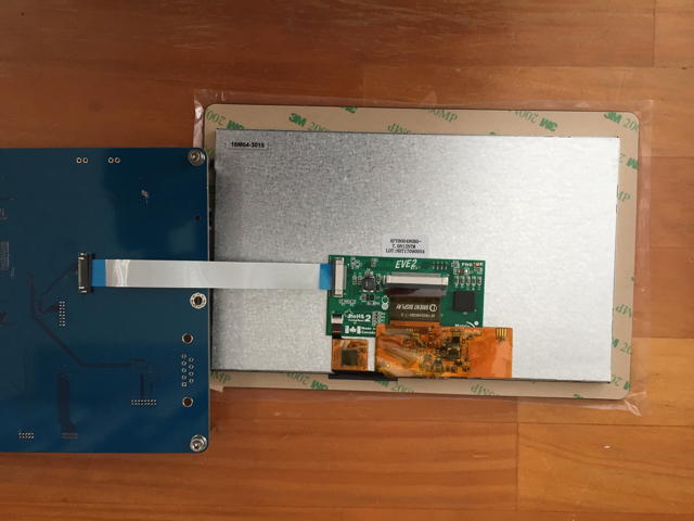

Re: Using Touch panel
Hello rascalito,
Can you please send a photo of your setup right now? Front and back of the display please?
I just want to check connections on the board.
rascalito
Posts: 38
Joined: Sat Apr 18, 2020 11:22 pm
Post by rascalito »
Hello Rachel!
Thanks for your reply.
Sorry, but I don't understand what the picture will change. Especially the front picture,
which shows the reflection of my face when I took the picture.
Here is the setup and a closeup of my setup.
The board is not the final one, but it's working, I get images that you can see in my previous
messages (therefore I can access the FT813 registers, and I should be able to configure the
touch panel as well). But all what I can read in the touch register is 0. The touch panel chip
is a Goodix.
R.
Thanks for the images. I just needed to see the connection of the touch panel, and it looks good.
