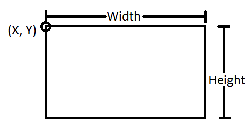

To create a region, you specify the X and Y, which are the Top Leftmost corner of the Region. Then you specify how wide, and how tall your region will be, as shown below.
Create a touch region GLX.png (3.35 KiB) Viewed 42324 times
To calculate the equivalent:
X1 (Rectangle) = X (Region)
Y1 (Rectangle) = Y (Region)
X2 (Rectangle) = X+W (Region)
Y2 (Rectangle) = Y+H (Region)
