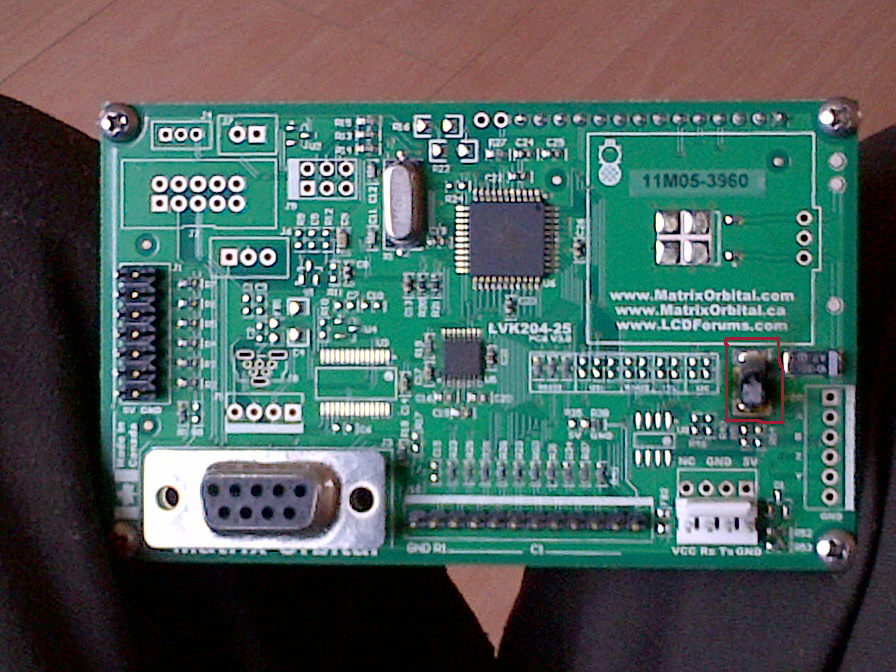

- LVK204-25 .my default component shown in red ,can you help identifying this part ?
- IMG_00000019.jpg (402.77 KiB) Viewed 12985 times
Can anyone identify this component circled in red in photo, it has burned and needs replacing.reostat wrote:thank you Clark , i will replace and go back to square 1 . For practical purpose ,Clark wrote:No worries Reo,

Hi Reo,
I see you've done quite a number on that board. The large burnt component you have circled is a 100uF tantalum capacitor, with the white negative polarity mark at the top, the one to the right is a 10uF tantalum, it too may be burnt. You may also want to check on R52 and R53 at the bottom right, those are 0 ohm resistors used in the power line.
Once those repairs are made, please check the manual before powering again to confirm the correct connector and pinout (I believe you'll be connecting to the power/communication header using the pinout in white on the board, but please, please double check).
hi TroyClark wrote:Hi Reo,
ok so i installed the burned tantalum and the 5V is making it through ,
but still same result as day 1, nothing is working, do i need a driver or something, uProject is installed COM indicating that the connection is established but the display is not giving any sign of life .i have tried straight pc to display rs232 connect , and tried also with the other scenario connect with power communication cable connection method, still nothing,what am i missing,
regards reo
