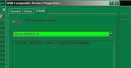

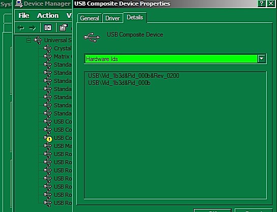

Hi Troy,
just to confirm are all the headers without jumpers ?
I'm thinking maybe a jumper link fell off one of the pins
Tried 2 more pc's, no go
3 cables test OK
um, windows detects no prob, but composite device has a yellow ! in device manager and error code :
MICROSOFT says:
If a device is unknown (usually because of missing drivers), the device has a yellow question mark next to it.
"cannot start device code (10)"
Here's whats in the drivers folder files: path(C:/program files/MO DriveCore/drivers)
gx_fwu.cat
gx_fwu.inf
gx_irbus.inf
gx_lcd.cat
gx_lcd.inf
gx2_lcd.cat
gx2_lcd.inf
WdfColnstaller01007.dll
WinUSBCoInstaller.dll
9 files total
I'm a little bit competent with electronics, is there any voltages I can test for or check data signals
I'm thinking if I could pull it apart, measure to see what components may be faulty ????

GX no text but has backlight
Hi fellas,
I sent you PM (Ray & Troy), a short vid, and jpgs
please let me know you got them
regards,
Adrian
regards,
Adrian
- Graphic_10_5_2010 1_20_53 PM.jpg (21.81 KiB) Viewed 25125 times
- Graphic_10_5_2010 1_20_48 PM.jpg (45.09 KiB) Viewed 25125 times
- Graphic_10_5_2010 1_21_09 PM.jpg (35.37 KiB) Viewed 25125 times
