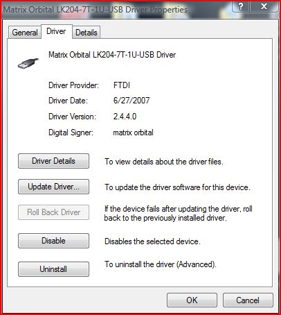

I may have been wrong on the signed drivers, and I am using 2.4.4.0 drivers dated 6/27/2007
they do show as signed.

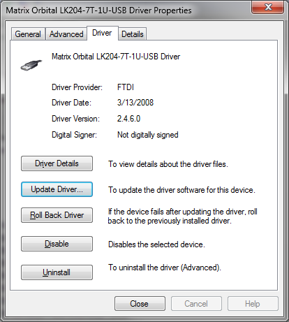

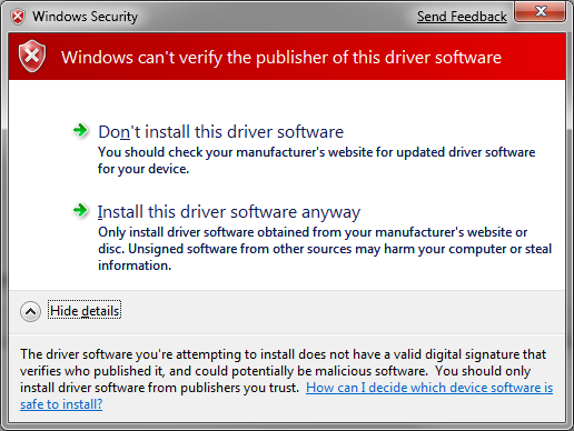

I saw that FTDI had 2.4.6 available I did the modifications required for our pid/vid and signed the package so they'd load on X64 i'll PM you the link, please let me know if this make it behave any better on your computer.

Ray wrote:I saw that FTDI had 2.4.6 available I did the modifications required for our pid/vid and signed the package so they'd load on X64 i'll PM you the link, please let me know if this make it behave any better on your computer.

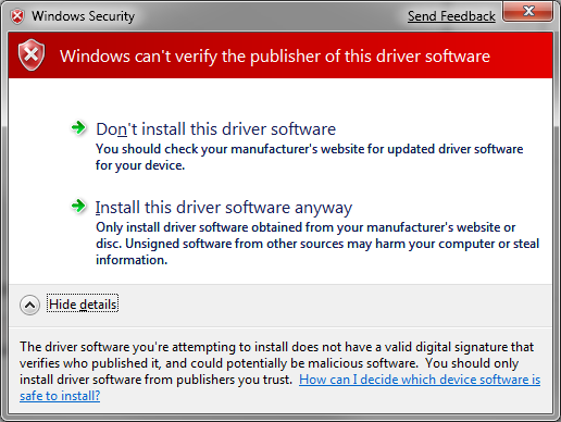

Also it still says the drivers are unsigned :(
