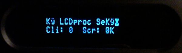

as well as the "MO Xboard" logo once again. I don't know what I had done or if the display was confused or what .. regardless I was able to get the logo once again. As previously mentioned, I am using LCDProc and a VFD that came with a HTPC case. The VFD displays some strange characters and some that make since .. but it's not like a baud rate problem. It is really difficult to connect the Xboard to a windows machine when it is connected to the VFD as they are in very geographically diverse areas of the house.
Is there a manual available for the USB version of the xboard? I know there must be commands available that aren't listed in the Serial or I2C versions as there is not an INIT jumper to program it like the Serial version. I told the mogd# (i think it was) that it was a 16x2 display .. so I think it is aware of that ... but I plan to order more xboards and I would like to know all there is to know about it so I can go about programming them intelligently.
As soon as I can reorient equipment (or order some additional Xboards) I'll do some more experimenting, probably with both LCDProc and with uProject in order to send raw data to the XBoard & Display(s).
Bruce
Current display with LCDProc
Good to hear you are somewhat up and running again! There's another thread going on about our VFD's and lcdproc aparently there's abug in the driver. not sure if it is the problem you are having but its worth a shot right?
