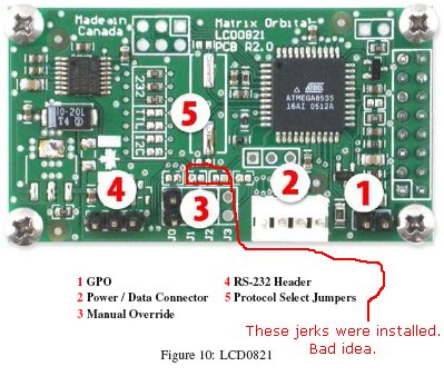

Little tiny resistor/jumpers, that's what. No, not the ones that we are supposed to be soldering/unsoldering to switch from RS232 to I2C mode (whose great design decision was that anyway?). These were little unlabeled, undocumented resistors just above J1 & J2.
All the displays that accepted (and saved) the non-default addresses did not have these resistors installed. All the displays that were giving us grief did, and they all happen to have the same role in our systems, namely 0x56. (Conspiracy?)

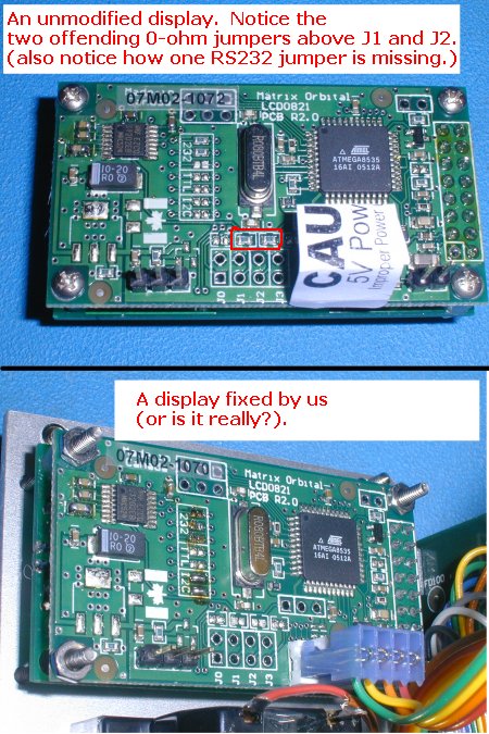

These bad displays appear to function fine after we removed the offending jumpers above J1 and J2. See attached pic.

- Bad-Good_01.jpg (118.21 KiB) Viewed 9445 times

What they are is legacy jumper block. On the older units we used the 2x4 header to set the I2C address and Serial Speed, but we moved over to a software based configuration. The reason the jumpers are there is for certain customers that do not want software configurations but require a hardware configuration, so we can use the 4 603 pads to hardware the communication configuration. If the jumpers are populated, they override any software setting that may have been loaded into the display. Now, why were they populated, that is a mystery.These were little unlabeled, undocumented resistors just above J1 & J2. All the displays that accepted (and saved) the non-default addresses did not have these resistors installed. All the displays that were giving us grief did, and they all happen to have the same role in our systems, namely 0x56. (Conspiracy?)
Production has been flogged, defenestrated and made to sit in the corner for a hour to think about what they did wrong, and have told me to tell you they will buy you a a couple of cold beers and a Alberta steak if you end up in Calgary.Someone shipped us a bummer batch of LCD0821's. Someone made me miss having dinner with my kids. Someone owes me (and the poor sap that I'm working with) a couple of beers.
Since the jumpers are not to be populated, they will not be documented, but production procedures will be updated so this does not happen again.May I most humbly suggest that a minor note be added to the manual describing the function of these nearly-impossible-to-notice resistors/jumpers whose function appears to be nothing more than to give us users stress, heartburn, and high blood pressure?
All LCD0821 displays are supposed to have a 2pin jumper at J0 and the 4 603 pads right above the header are all supposed to be not populated. As well, for future reference we can set all the displays to I2C by default by contacting sales and getting a customer number from them. Hope this answers all your questions, if there is anything else, please let me know.

Oh dear. I would never encourage any of our end-users to dribble solder all over any of my preciously (precariously?) designed pcb's. In the same space one could have chosen to install a miniature smt dip switch (and have less warranty calls). ok, maybe a little more space. But you wouldn't be dealing with griping hooligans like me.They [itsy smt jumpers] were my idea the reason they are there is for large scale production, we are able to set the units to I2C or TTL or RS232 by placing these 0 ohm resistors in the switching matrix, making them easier to manufacture in larger volumes and less expensive.
