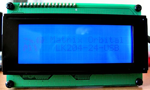

Hi, I recently bought an LK204-24-USB display and was very happy with it until it broke last night :( The contrast appears to have set itself to a very low value (see attached image) and trying to change it with uProject has no effect...
I think I may have inadvertently shorted the +5 and GND pins on the GPO connector - but can't be sure.
Is there any hardware option I can try to reset the contrast, or is it fried?

For anyone interested, I ended up sending the display back to MO for repair. Apparently a transistor used in controlling the contrast level had blown.
