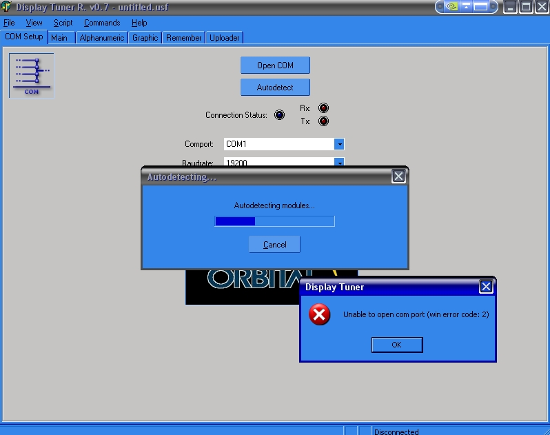

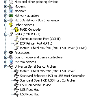

This is what my device manager looks like, everything appears to be working fine. (See attachment) I also tried to use Uproject's Auto Detect Feature, and got an error message. (See attachment of screenshot for this one as well)

Yeah, I also removed the registries as well, but still nothing. It sits at default startup screen and wont be detected.

You mean removing the three drivers underneath the MO MX2 Driver?
--One of those drivers is for my keyboard, so it'll have to stay. I'm not sure what the other drivers are for.
Actually, I didn't spot that earlier, but the raid controller maybe causing a conflict with the usb driver. Try resolving that issue first.
