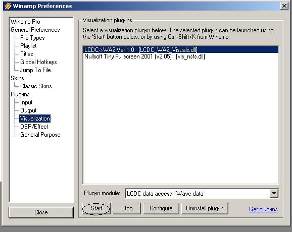

Pete,
I have used Winamp 5 with LCDC. You need to copy the LCDC_WA2_Visuals.DLL file into the winamp's plugin file. The file is part of the winamp 2 driver. You will need to start the winamp plugin after you have installed it. The picture below will show you how to start the plugin. You can also get additional information at http://www.lcdc.cc/help/plugin_WA2.htm
You can then use the winamp 2 plugin on LCDC. I suggest you experiment with a new screen builder page instead of the example to learn how to use it better. The winamp 1 to 10 are just the names of each screen.
Winamp LCDC set up.JPG (41.7 KiB) Viewed 8917 times
