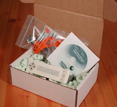

The following products have been shipped to you:
* 1 Display and 5.25" Drive Bay kit
* 1 12V power cable
* 1 12" serial cable
* 1 -4BR cable
* 1 Matrix Orbital eCD
If any items are missing please contact us at 403-229-2737 or email sales@matrixorbital.com and the problem will be corrected immediately.
Installing the BLK202A
Before installing the unit, please ensure that all of the items in the packing list have been shipped and have no physical defects.
