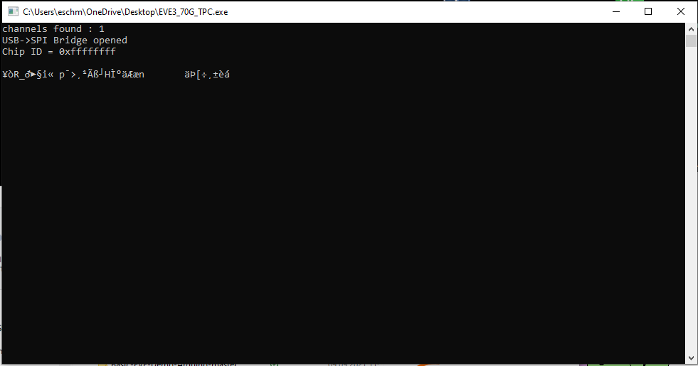

First try the shell just stopped after" USB->SPI bridge opened"
Finally these was caused by external ground connected to the pads because i wanted to supply extra current over my breadboard as it is requested within a couple of threads.
What is interesting is that when the USB2SPI board is hooked and powered up, there is no voltage shown on the Vin Pad. (Diode?)

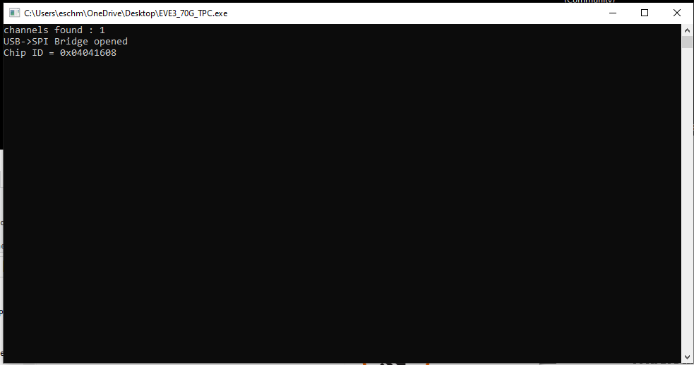

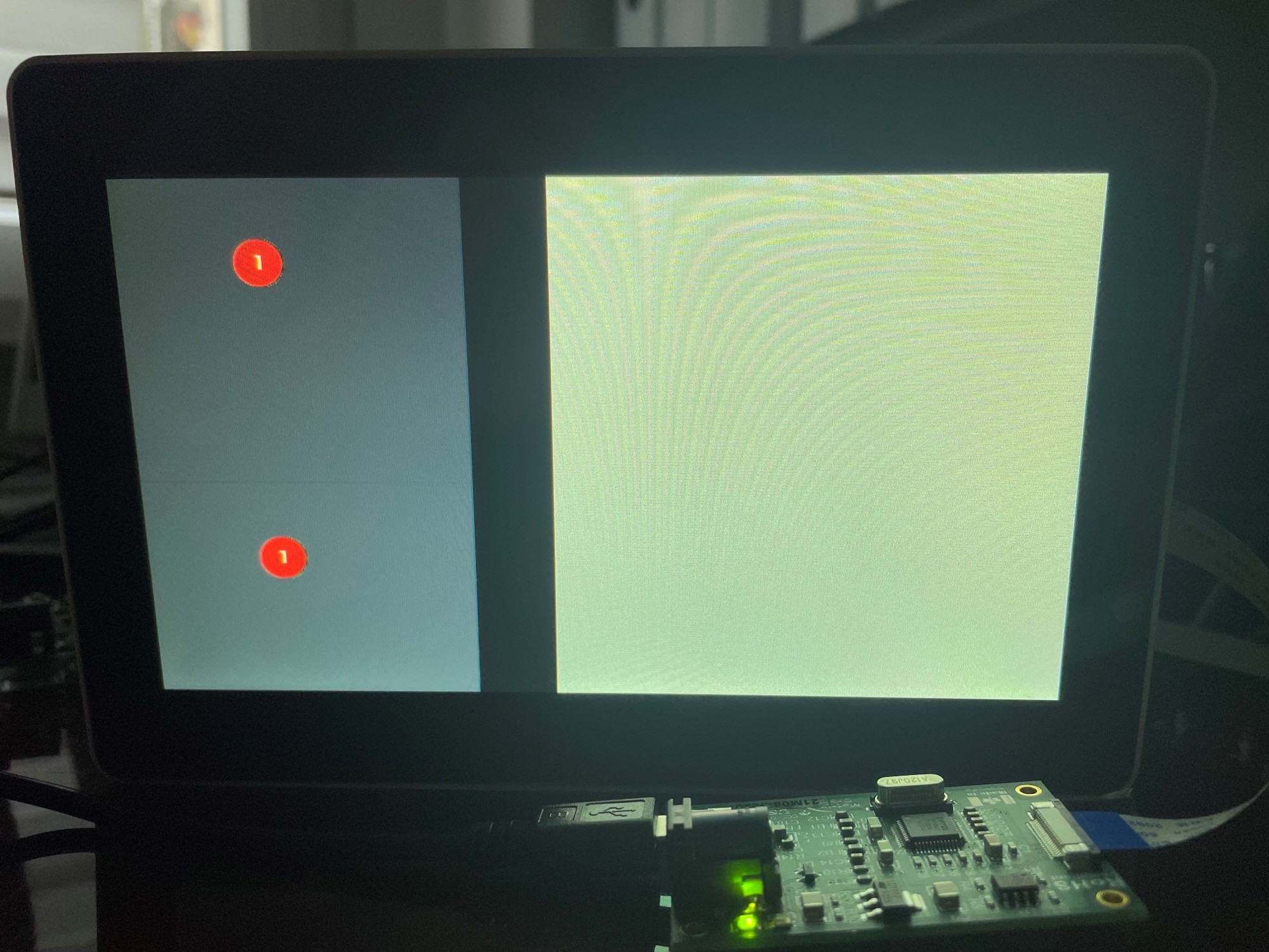

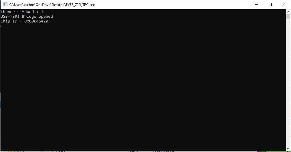

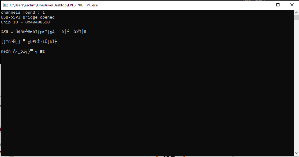

When fully separated the circuids i get a chip ID delivered and the display turns on by accident. But the ID's delivered are wrong all the time and changing randomly on every try. I run the extra Voltage with 12V 2.5A powersupply at the USB2SPI
In the most cases, when trying to connect there is no output, but sometimes it initializes per accident and then i got output like that.

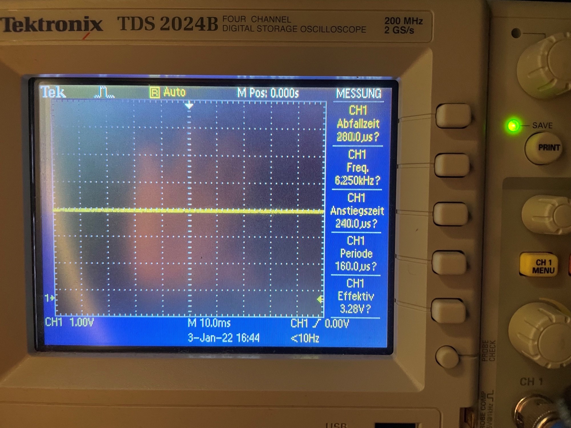

Voltage output of U3 is stable as checked with Oscilloscope when display is not initialized (but powered).

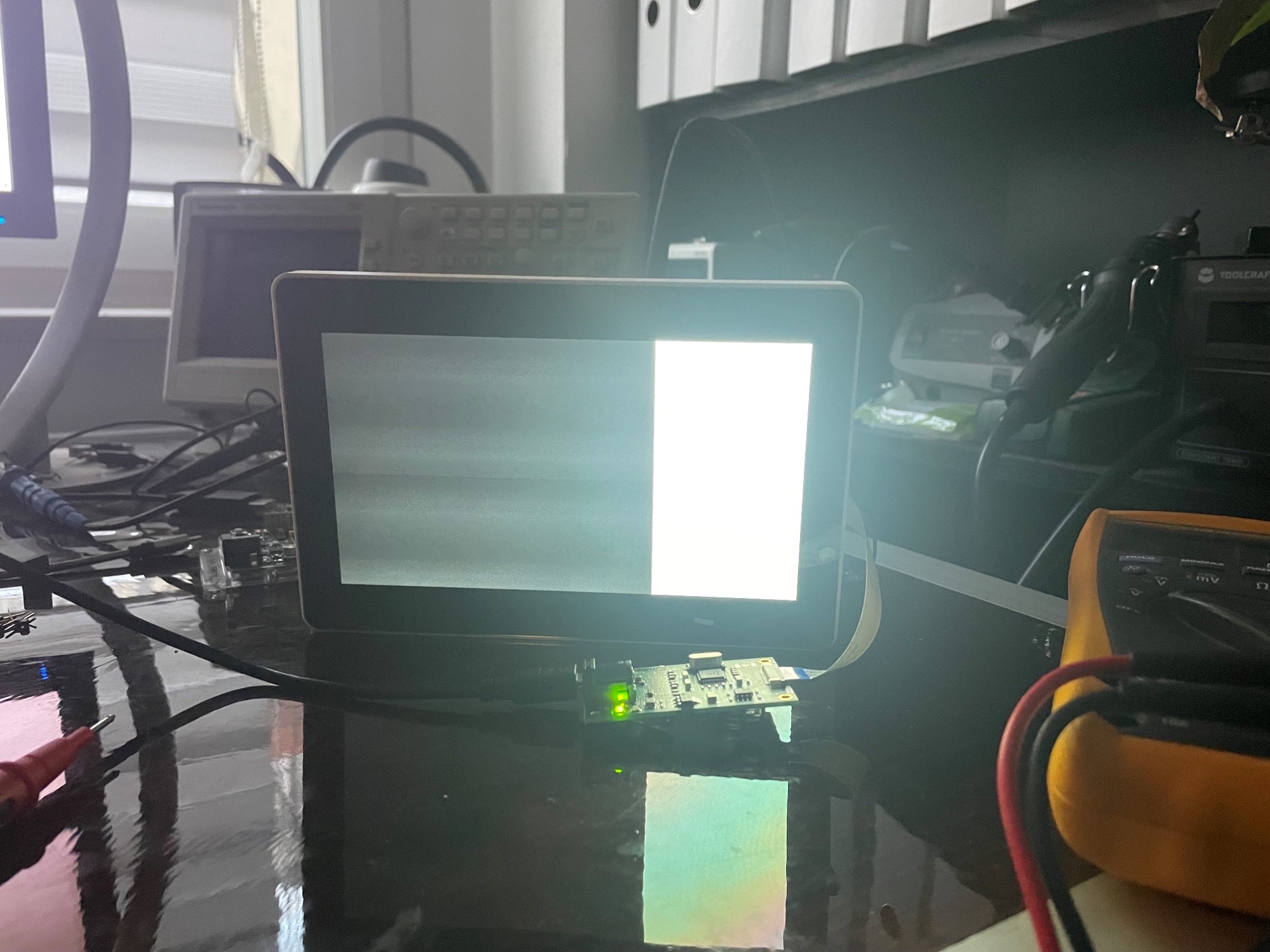

What i found during testing this afternoon was quite a bit strange.
When the Display is switched on by accident, the Voltage drops from 3.35 -> 2.7.
The average load at my switching PS is between 60-110mA.
Voltage Regulator @USB2PCI is around 40C°.
Basically the current should be balanced between both inputs. But either display isn't pulling so much current or it is not balanced between the 2 Inputs. is not easy to measure the current coming from USB2SPI with my technical setup at home.

Edit: and your scope can do screenshots :-)
Edit2: oh, das TDS ist auf Deutsch eingestellt
