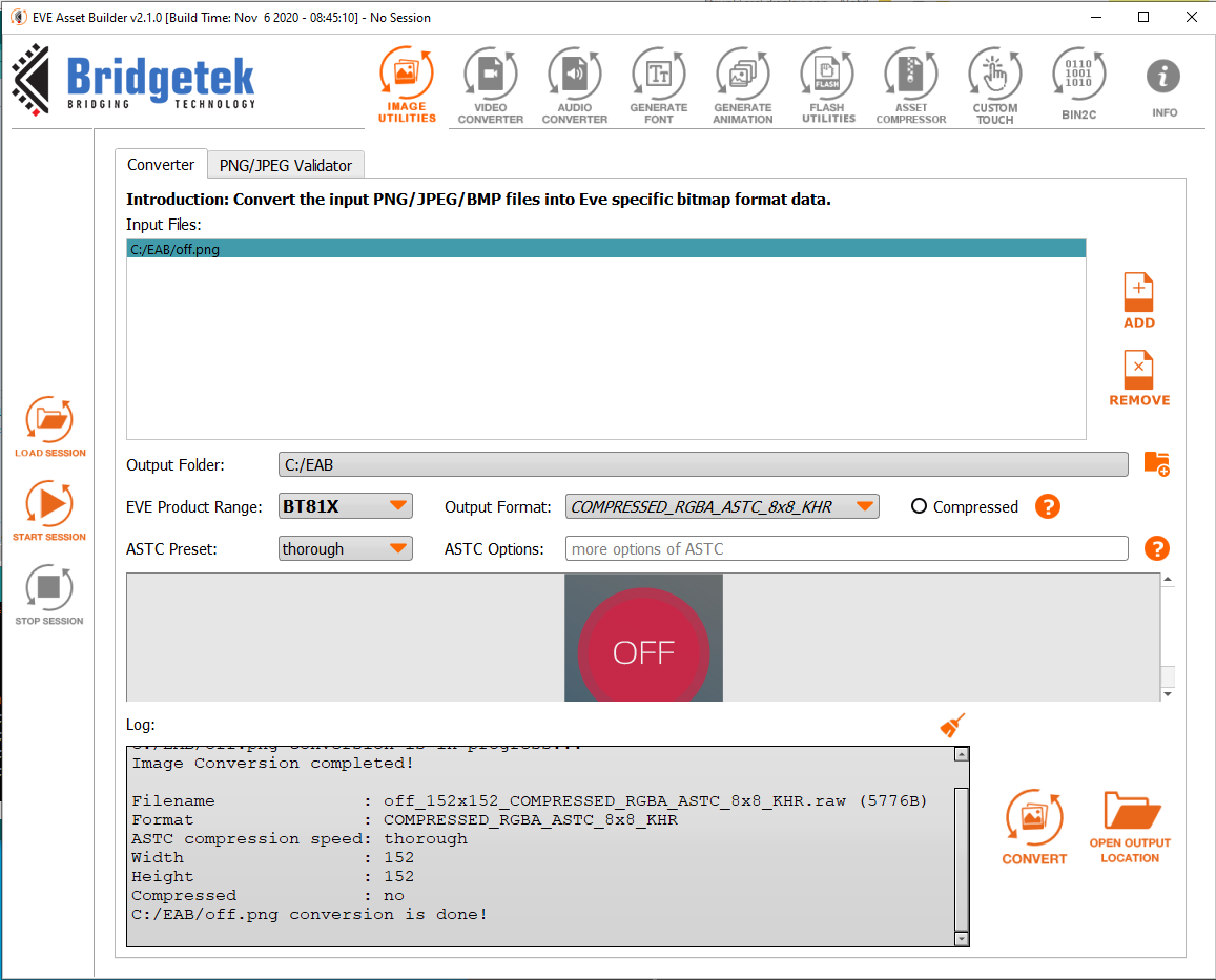

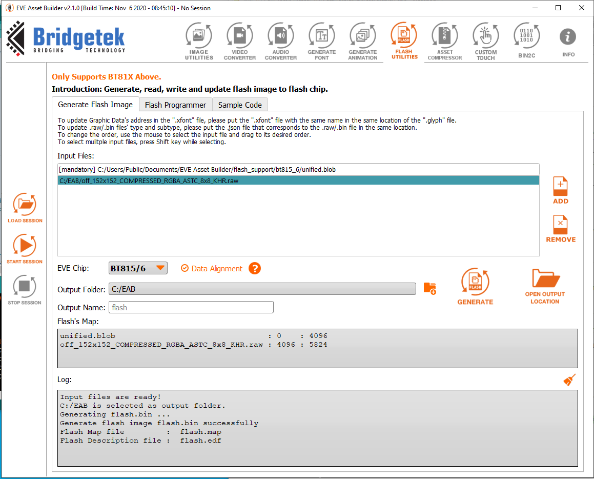

Great, so now time to build the 'flash' array. Here is my procedure:
1. Convert the image to EVE_COMPRESSED_RGBA_ASTC_8x8_KHR, default options:

2. Generate flash image with the blob file automatically included and adding my previously converted EVE_COMPRESSED_RGBA_ASTC_8x8_KHR.raw file

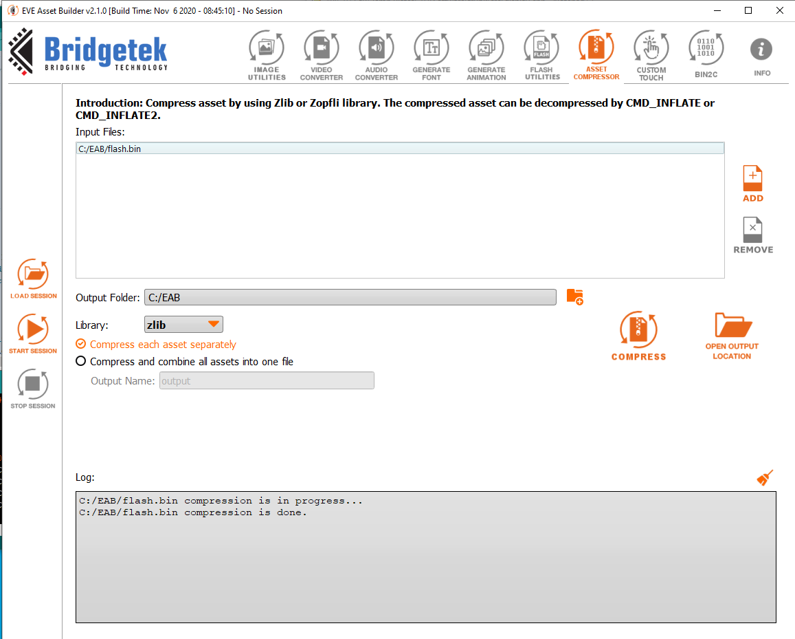

3. Compress flash.bin file created, default settings:

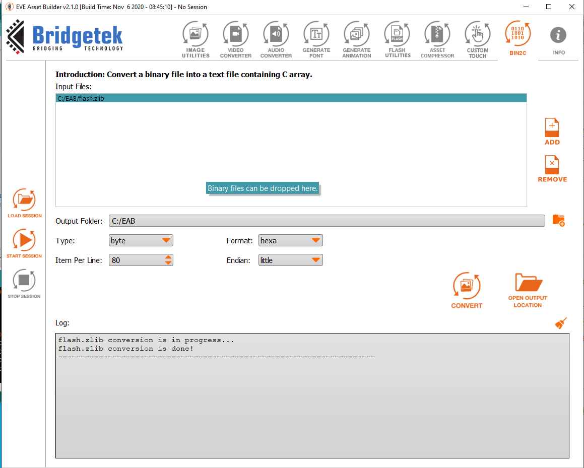

4. Convert Binary file into text file with C array:

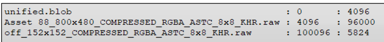

My only question now is the proper addressing for the flash address once I get past the first address (0x800000 relative to BT, and 0x000000 relative to flash). My basic map is as follows:
Screen Shot 2021-05-24 at 6.01.49 PM.png (72.2 KiB) Viewed 8281 times
What is the address of the third item?
Alex
Rudolph
Posts: 67
Re: Loading Custom Backgrounds / Buttons / Images
Post by Rudolph »
As the third item also is an image, it's just the same, address in flash divided by 32.
0x800000 to indicate that the address in the external flash
100096/32
-> EVE_cmd_setbitmap_burst(0x800000 + 3128, EVE_COMPRESSED_RGBA_ASTC_8x8_KHR, 152, 152);
