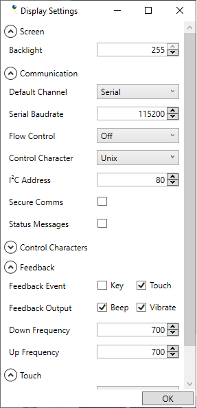

I am trying to ge the LCDs to work with a UART connected to a MCU. I have the following LCD:
GTT43A-TPC-BLM-B0-H1-CT-V5
GTT70A-TPC-BLM-B0-H1-CT-V5
I have it all setup and configured through the GTT Designer to be a Serial connection.
This is the code:

Re: UART
Hello H,
The default setting for serial communication on the GTT is 115200 baud, hardware flow control on.
Do you have all the 4 pins connected (RX/TX/CTS/RTS) connected to your MCU? I see that you have this figured out now, though :)
You can have your UART hardware level via ISR, and place the data in a buffer.
But the gtt_parser_process(gtt) should be polled in your main loop.
Yes, an echo command is a good command to use to check if the GTT is ready, or when you are trying to make sure you are in synch with the display.

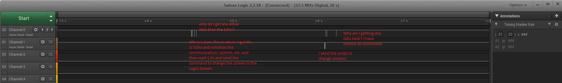

Haz
Posts: 38
Joined: Wed Jun 28, 2017 8:52 am
Re: UART
Post by Haz »
As I build up the project, I discovered some details which cause issues and I need help to figure them out.
Here is my Display Setting
I have a script which runs after the SplashScreen is on and Echos 'x'.
If you look at the protocol below, I see the 'x' which triggers my program to know that the LCD init is done. Wait 1.5s on the Splash screen and then run the scrips to change the screen to Login. All of this happens on the TX line of the LCD which is all exactly as expected.
What is not expected is the data which is coming back. Having no interaction on the screen, why am I getting anything on the screen.
I am also attaching the Serial XLS so you can see both channels and timing, along with the data being exchanged. Also attached my autoexec text file showing the comms setting.
Debug Serial.xls
(34 KiB) Downloaded 3787 times
autoexec.txt
(32.7 KiB) Downloaded 3780 times
The logic I have is I am expecting only communication from the LCD when a user event happened. I am running the parser when I get data from the LCD. so when I get data from the LCD, a call to the UART interrupt happens, and that notifies my FreeRTOS task to run the parser. That way my system can be asleep, backlight dimmed, until someone touches the screen.
Is there a way I can cut off any data from the screen unless it is something I m doing, like sending a command which send a response back, etc.
Thanks for the help.
