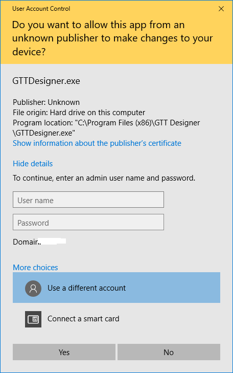

Every time I open the designer, I'm prompted for an admin password. Is this intentional?
A quick search gives me the impression that it's caused by not having a MS verified publisher certificate, but I also have a very oppressive IT environment at work so that may be related. Turning off UAC isn't an option. Anything else I can do to work around this?
Win10 Enterprise 1803
Thanks!
GTT launch.png (22.79 KiB) Viewed 24678 times
Re: GTT Designer requires admin privileges on every launch?
The gtt designer is actively requesting elevated privileges, the way the designer communicates with the unit requires this. If you drop us a line at support@matrixorbital.ca we can send you a copy that doesn't request these privileges, however, the automatic deployment functionality will not be available in this version.
