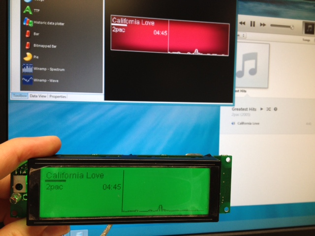

So... does anyone know if the GX Typhoon works with Windows 8 64-bit?
Dan.
Windows 8 64-bit?
Re: Windows 8 64-bit?
Hi Dan,
Yes, I have confirmed the GX does work in Windows 8...but it wasn't fun.
You will need to install Microsoft .Net Framework 3.5/2.0, and you will need to run LCDStudio as an administrator to have access to system information. I was unable to get Windows Media Center or Media Player working in LCDStudio, but iTunes information appears correctly and I must admit I had trouble getting much of anything working on Windows 8.
The latest GX software pack is available here and includes all the files you'll need to get up and running.

- GX in Windows 8
- photo.JPG (90.97 KiB) Viewed 37863 times
