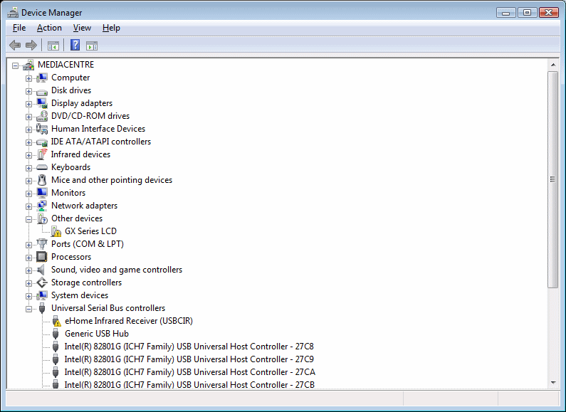

Ray wrote:Does the device show up in the device manager?
Yes it does. I have attached a screenshot of the Device Manager showing the situation.
Andrew
Hmm, in taking that screenshot I noticed the Irda device which appears to be built in. That's news to me!
Anyway, I disabled it and was then able to (nearly) install the driver for the GX hardware. I say nearly because the damn thing won't replace a file on the hard disk. And being Vista the security says I need admin privileges - which my logon has got!
I hate Vista with a vengeance.
So the device still isn't working. Trying desperately hard to get this sorted now.
Andrew

Ray wrote:You should be able to right click it, point it to the matrix orbital folder in program files and you should be all good to go?
As it is a brand new installation I reformatted the hard disk this evening and dropped Vista back onto it. Everything is working fine now. Leastways, everything I have tried thus far.
I hadn't realised that another Irda device could cause a problem of this nature. I bought the Antec case last year and never realised it had Irda built in! That was never advertised or referenced in the user guide that came with it.
Andrew
the IRda and lcd driver are seperate they shouldn't interfere with each other.
