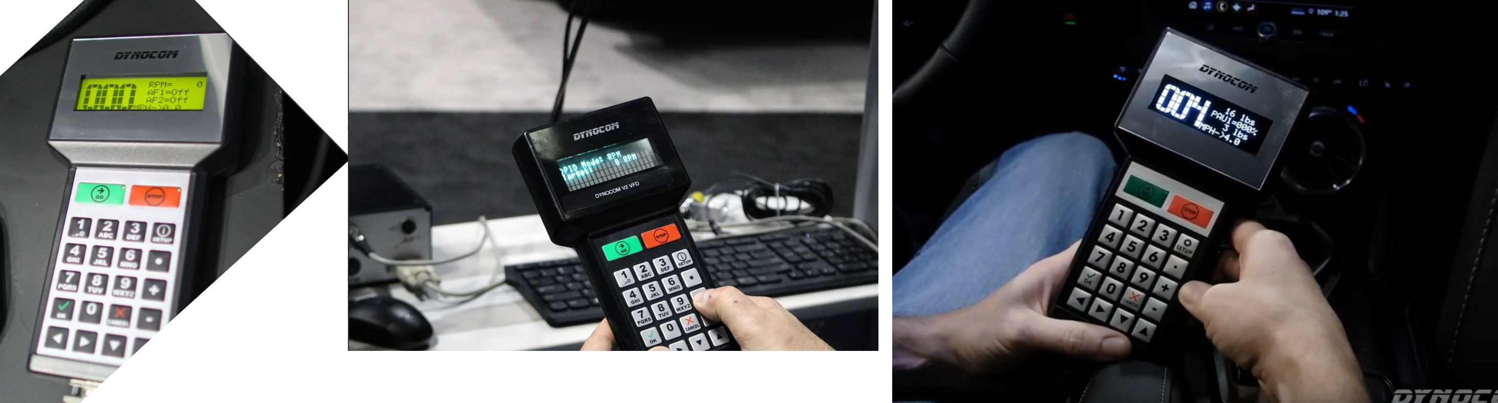

Let’s explore three different character display technologies. I recently came upon one of our very long-term customers who has used all three displays in the same product. All three displays are still produced and available. I want to give credit to Dynocom Industries (https://www.dynocom.net) for the pictures/videos that I borrowed. Dynocom Industries offers the most diverse dynamometer product line in the industry.

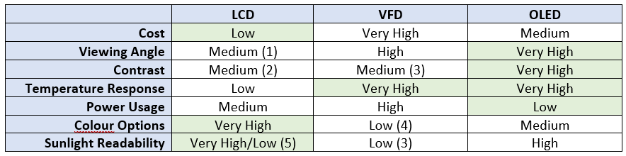

Here is a quick little chart to show the different display technologies and performance. Selecting the appropriate display technology is very important for any project. Please contact us and use our 20+ years of experience to help you select the perfect display for your application.
(1) This is partially dependent on the LCD type, a Yellow/Green transflective will have a higher viewing angle than a negative transmissive LCD
(2) This is dependent on the colour of the display, a positive FSTN white backlight will be better than a STN display.
(3) A VFD in direct sunlight will have a poor contrast ratio, with a grey polarized filter, it will have a much better contract ratio. In shade it has much higher contrast ratio.
(4) With a VFD filter you can modify the colour, but it is limited.
(5) Transflective displays are very high, Transmisive displays are low
