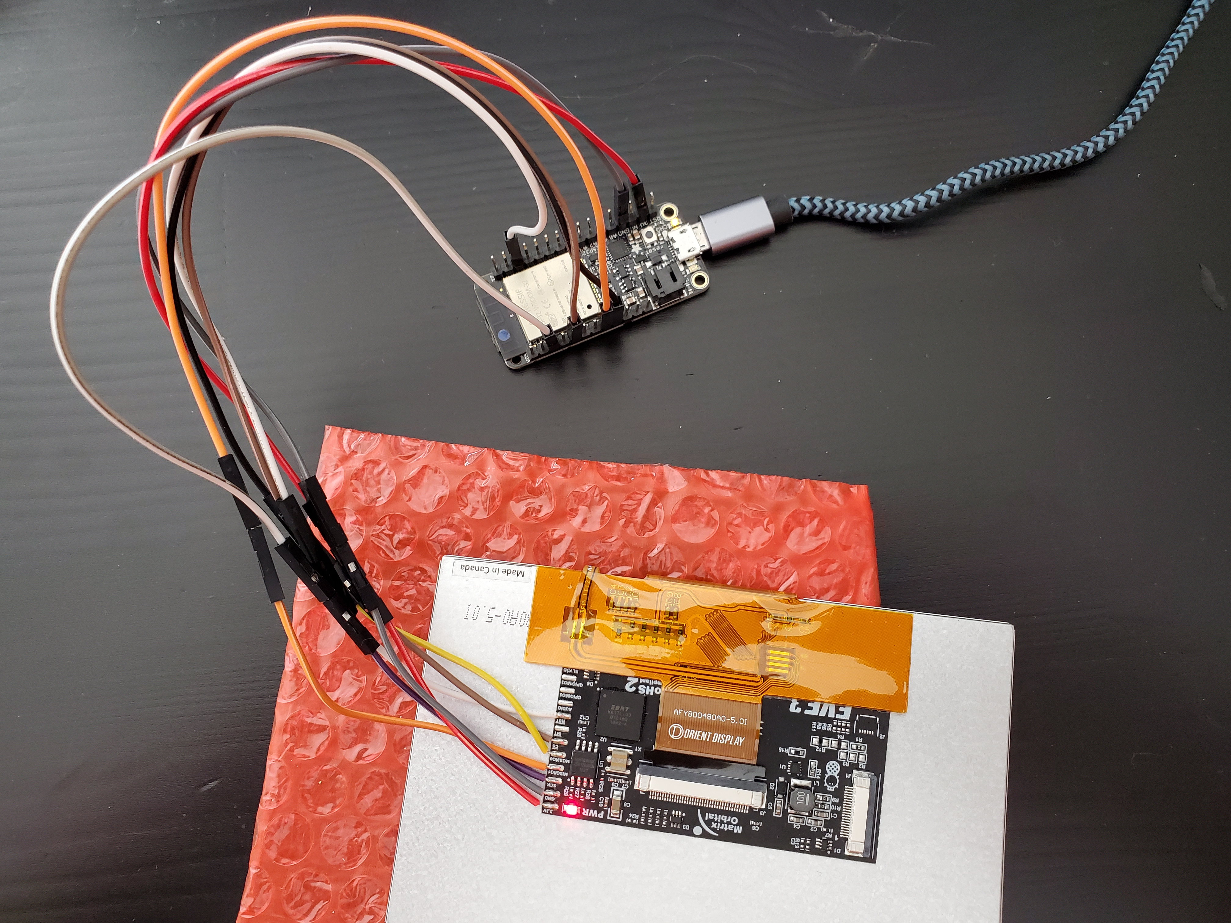

Good afternoon everyone,
I am seeking help in connecting an Eve 3 Display - https://www.matrixorbital.com/ftdi-eve/ ... e3-50a-ips
This is a non-touch model with 128 mb of flash.

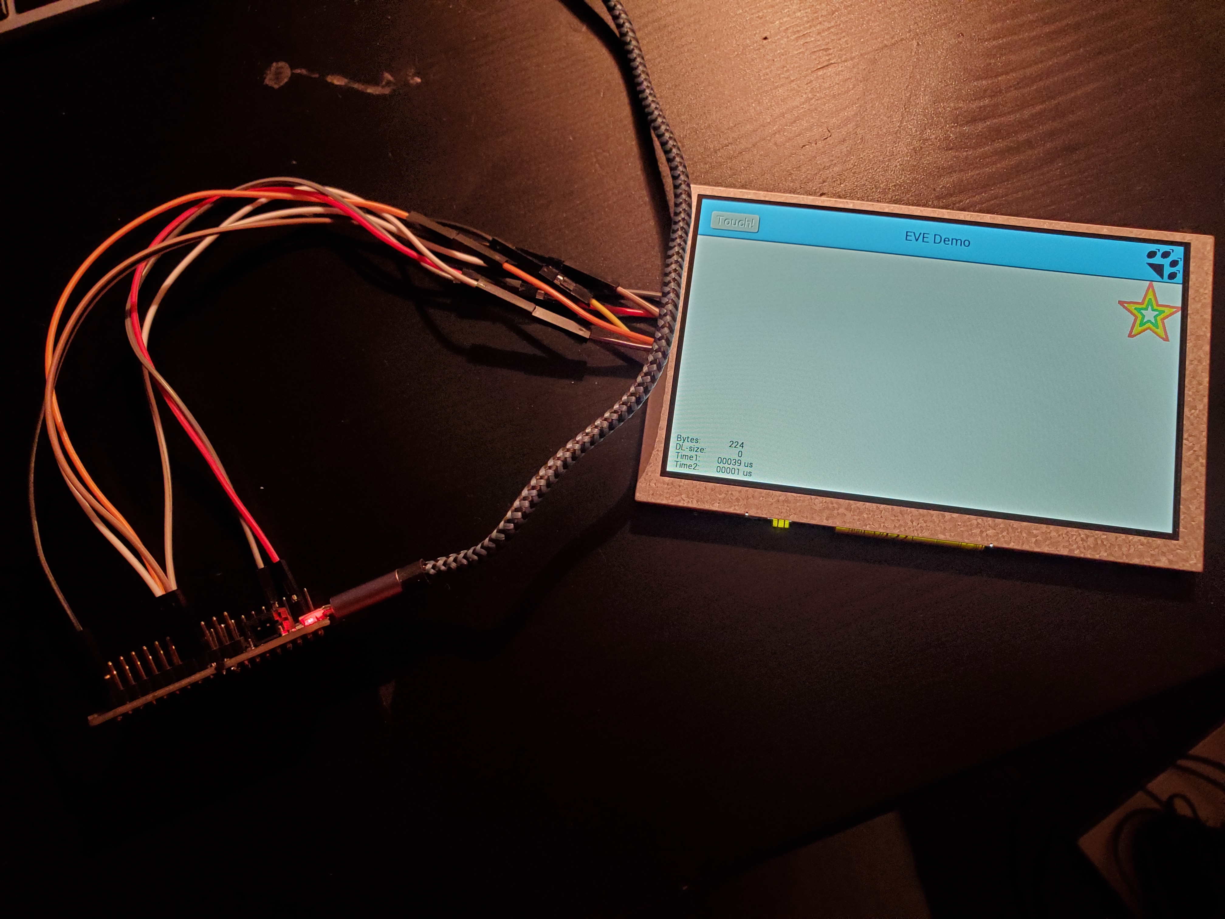

I am trying to connect it to an ESP32 board as per the included photo. I have compiled the https://github.com/MatrixOrbital/ESP-EVE3-Weather-Demo but I am not getting anything from the display.
In Serial, I am receiving Cmd_READ_REG_ID - fail, which I know means that the display is not outputting the 0x7C to initialize communication.
My question is it possible to connect to the display using a direct connection to an ESP32 board or do I need to use the SPI2BBC?
I have checked my wiring multiple times and have tried other ESP32 boards as well.
I appreciate any help and suggestions, I can supply more information, photos, etc. Just trying to get this running in a basic manner. Thank you!

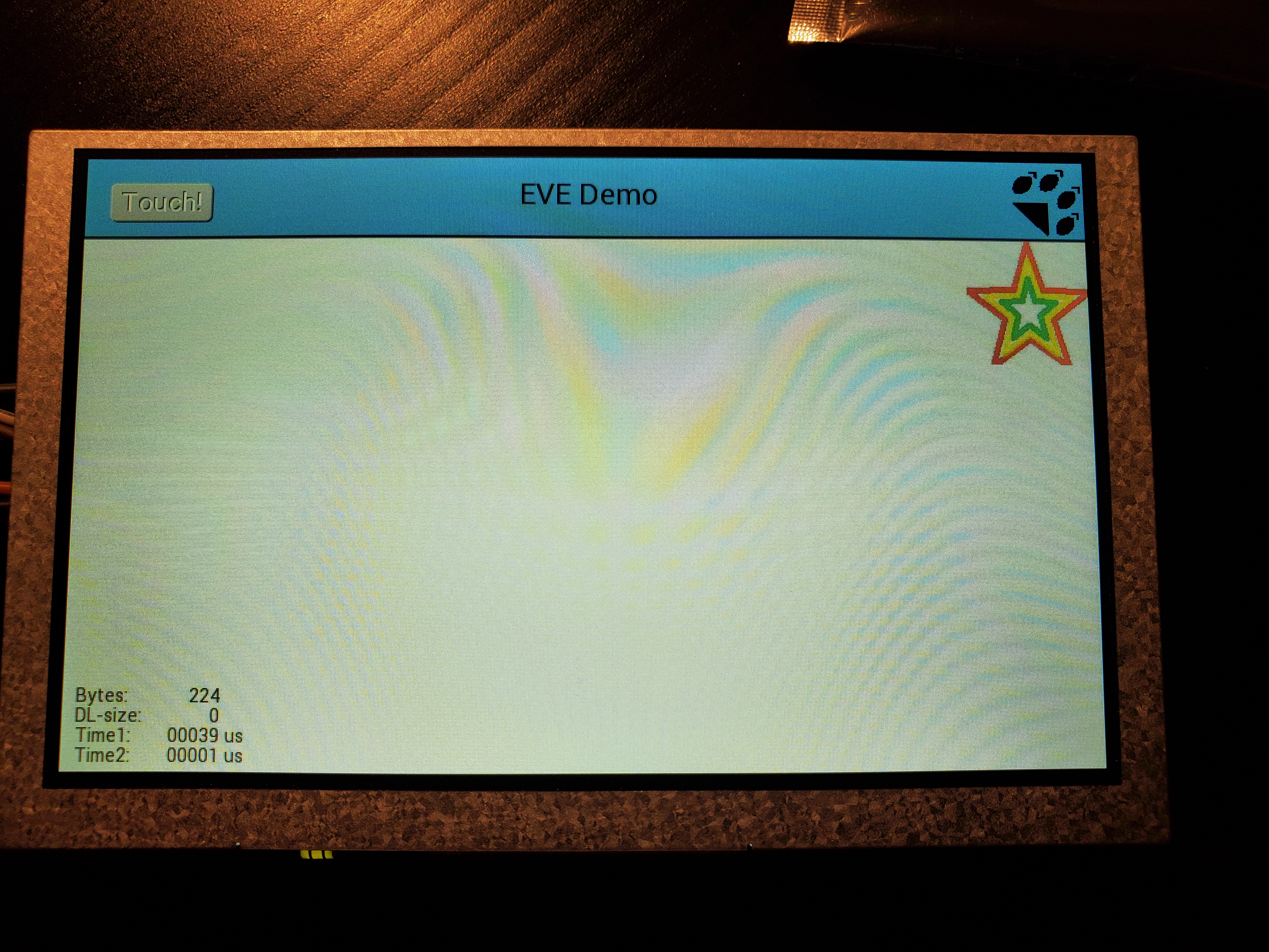

Re: ESP32 & Eve3 Display Help
Using Rudolph's code I got it to work!
I had to change the #define TEST_UTF8 from a 1 to a 0 under tft.c and the display came to life!
I would still like to be able to use the original Matrix Orbital example to connect to the display so I would like to see if anyone has a suggestion as to how I can overcome the 0x7C issue. Thank you in advance.

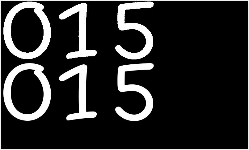

If you really need a complete font, you can put an UTF-8 font in the flash.
Also, what is the best way to display a very large font? A font that would take up 70% of the vertical space of the display for example. Is this possible with custom fonts?
I used a 140 point UTF-8 for a projekt on a 5" EVE3 display.
The compression however is extremely poor for fonts, mosty likely because ASTC always is 32 bit and then every glyph
is compressed separately.
My flash-image was 6.2 MiB with the .glyph file alone using 6 MiB.
When compressed into a .zip the .glyph shrinks down to 115 KiB.
It might be better to use a couple of images for only a small set of chars.
Annother idea would be to compose each digit with set of tiles.
Form digits from a set of 40*40 pixel tiles, 4 by 8 tiles for example.
I have no idea though if there is software out there that would break up a font at a given
size into the minimum amount of tiles necessary.
Or simulate a segment-display by drawing lines. :-)

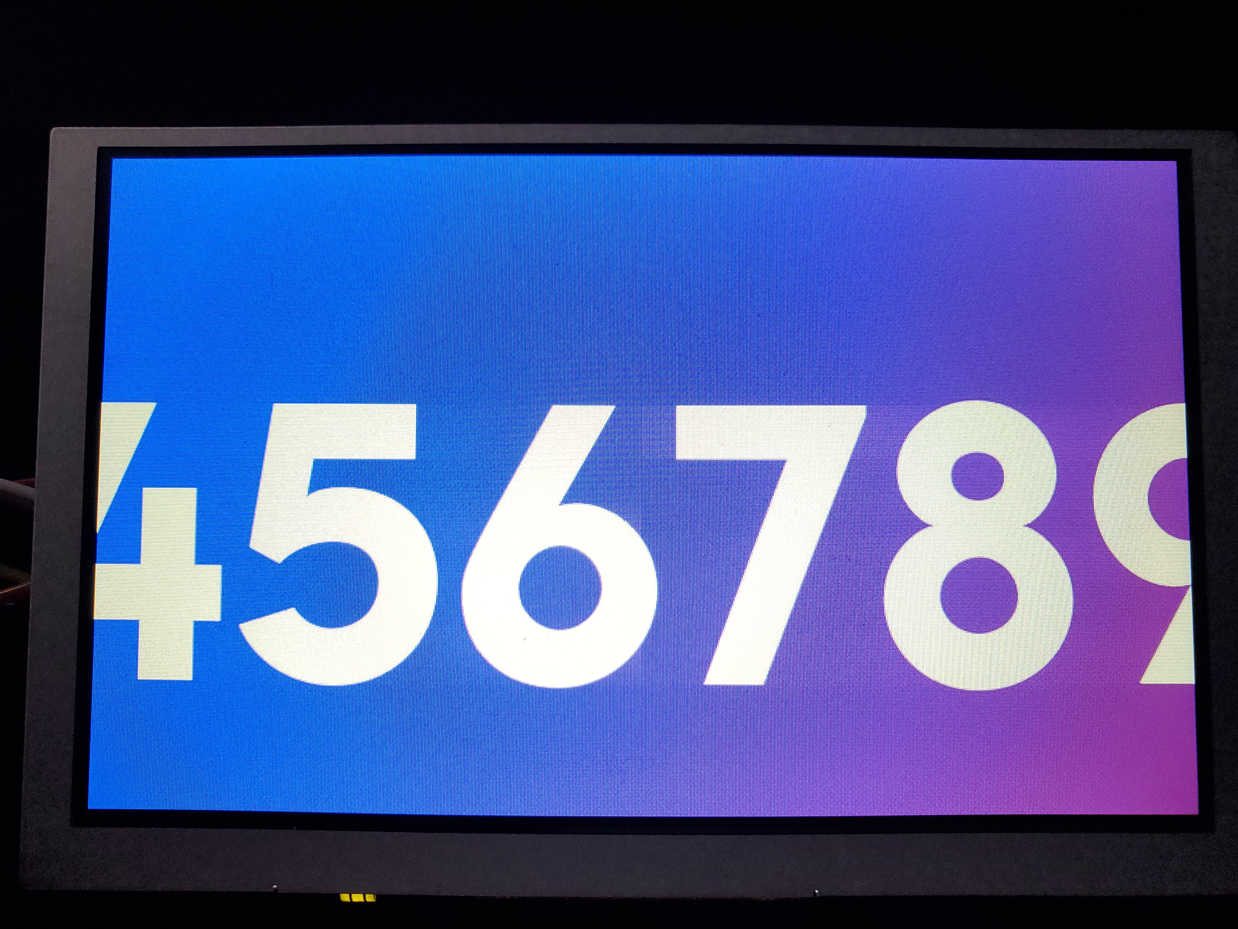

Thank you again, immensely helpful! I am trying to do things one small step at a time so I can learn what each change equates to on the display.
I started by adding:
//EVE_cmd_romfont(16,32); //First three lines commented out
//EVE_cmd_romfont(17,33); //First three lines commented out
//EVE_cmd_romfont(18,34); //First three lines commented out
EVE_cmd_text(500, 100, 31, 0, "Ding!");
EVE_cmd_text(500, 175, 16, 0, "Ding!");
EVE_cmd_text(500, 250, 17, 0, "Ding!");
EVE_cmd_text(500, 325, 18, 0, "Ding!");

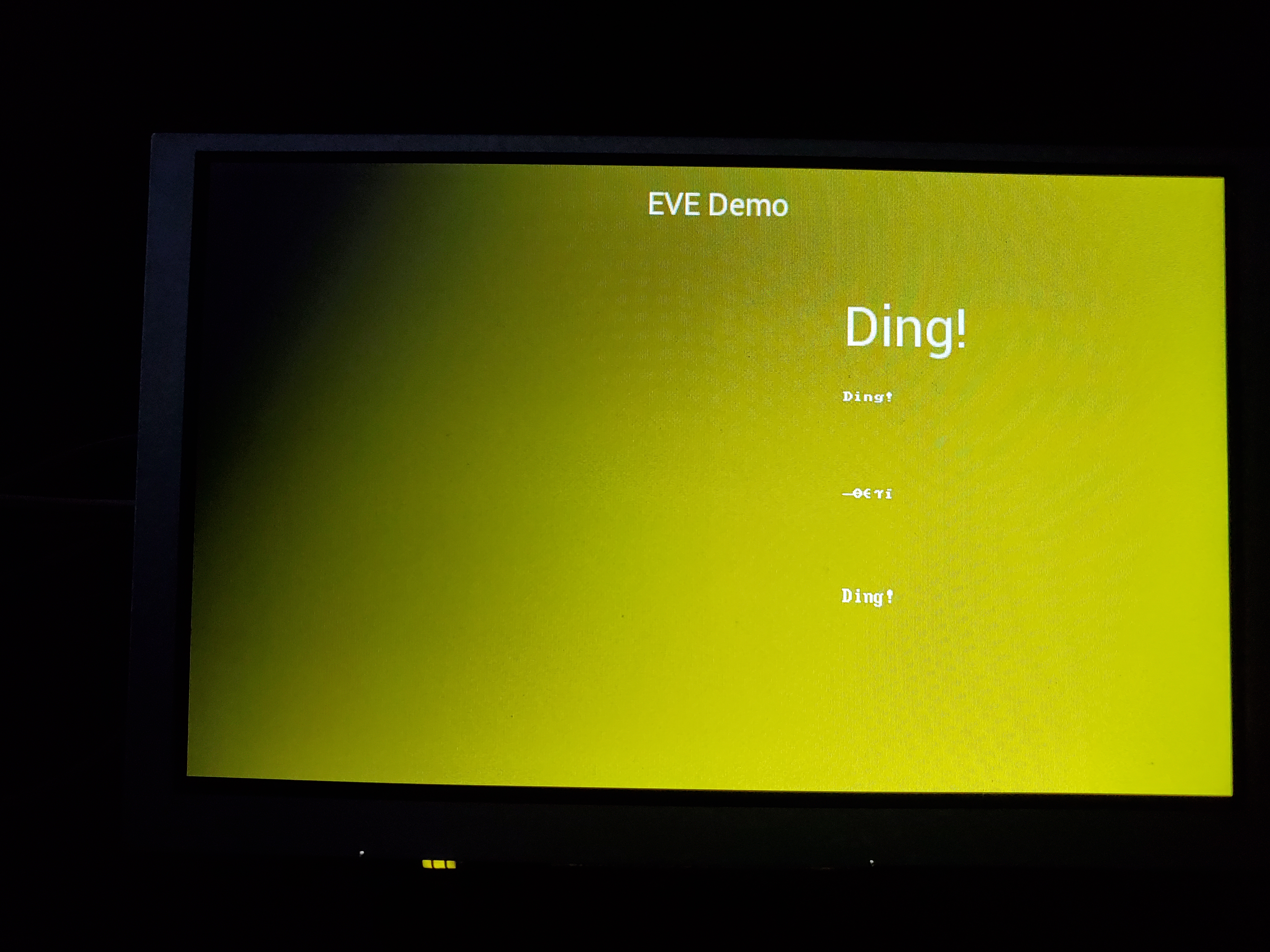

And this resulted in: And I saw that the third number in the command equates to a change in the type of font.
So then I tried:

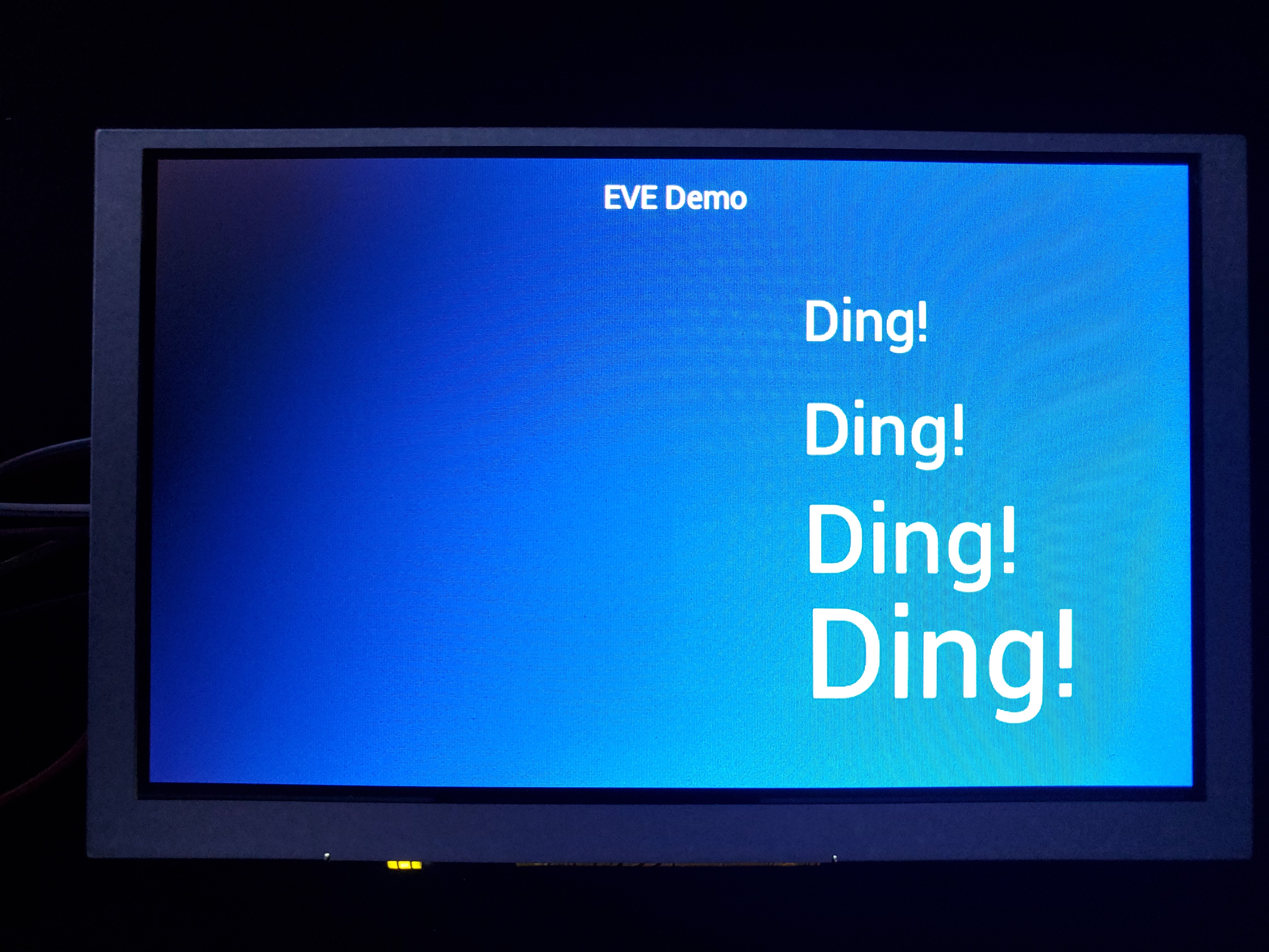

And this resulted in: So it looks like fonts 32,33, and 34 are larger versions of font 31. Neat!

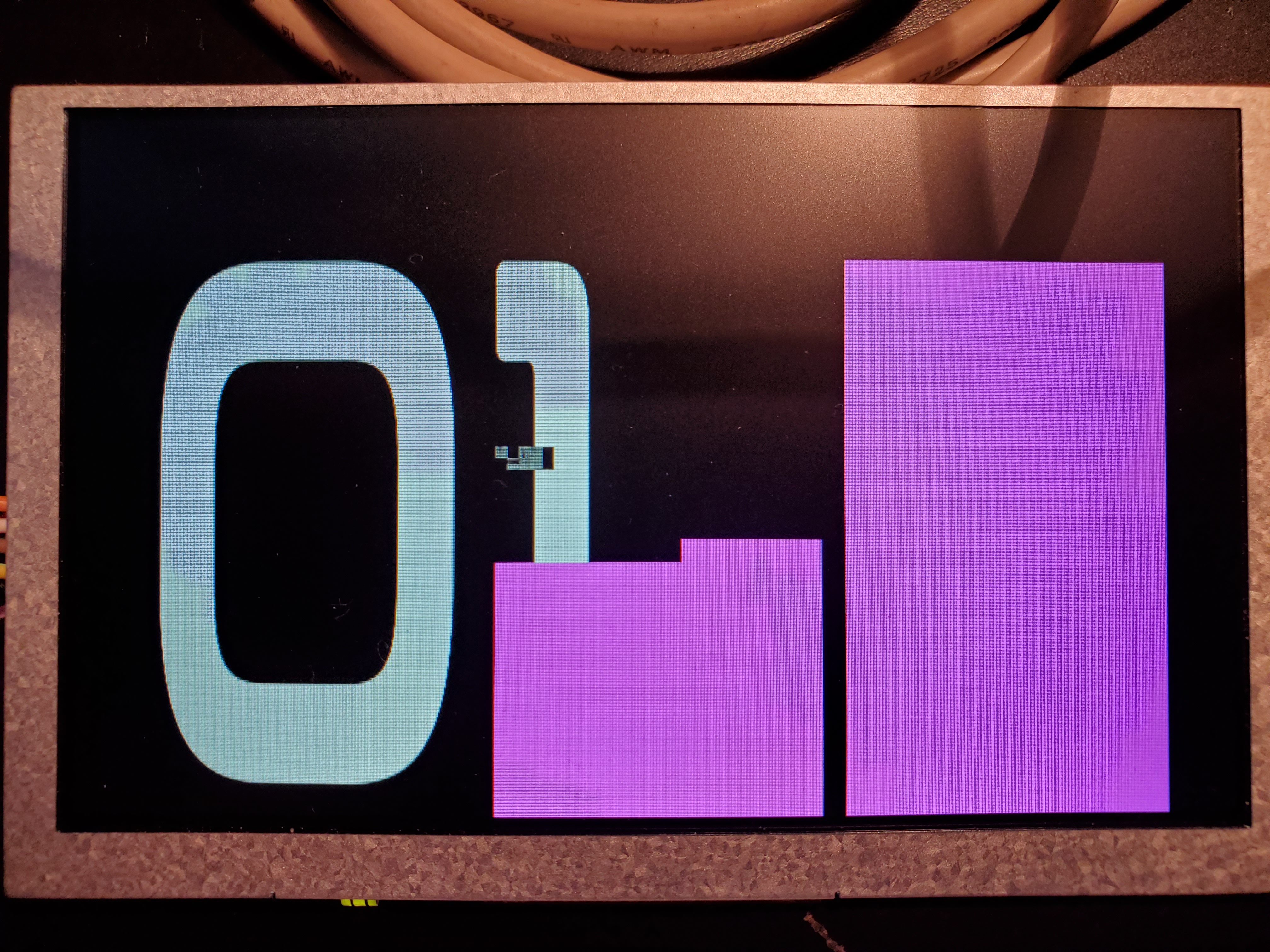

Then I tried to get the custom font working so I added:
EVE_cmd_setfont2(12,MEM_FONT,32); /* assign bitmap handle to a custom font */
EVE_cmd_text(200, 100, 12, EVE_OPT_CENTERX, "Arcade Font 12");
And of course that did not display anything until I added the font to the memory of the display by adding:

EVE_cmd_flashread(MEM_FONT, 84608, 4288);
Running that once and the commenting out the flash-image transfer code for successive runs. (I can see why you set the default to not use a custom font, makes sense now.)
That ended up with: (I commented out the romfont portion again)

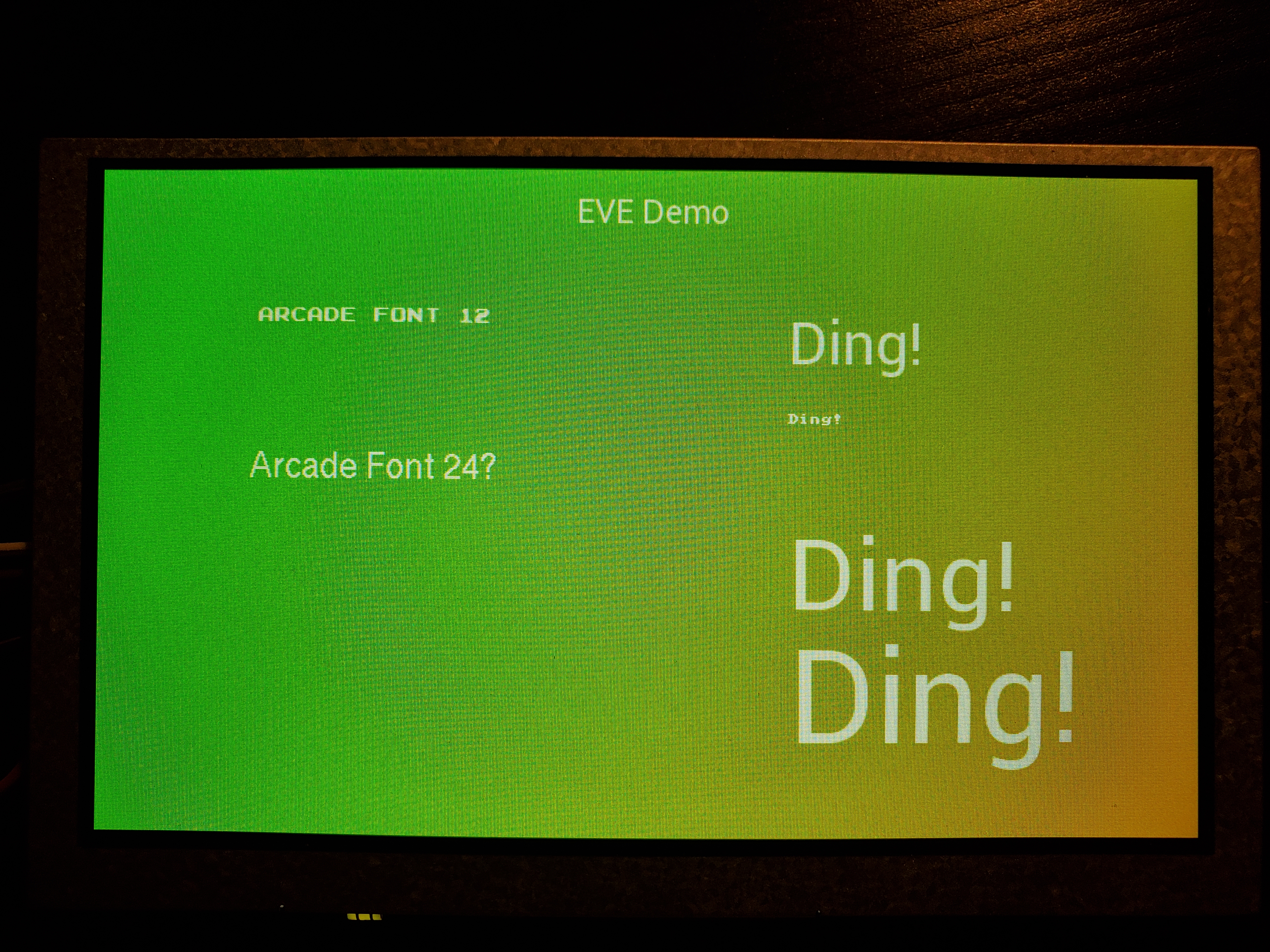

So then I tried this bit of code to see what happens:
EVE_cmd_text(200, 200, 24, EVE_OPT_CENTERX, "Arcade Font 24?");
I was hoping that the third item is possibly a scalar and would increase font size but instead I got: I am guessing that there is no way to scale a font, I would just have to upload the larger font and take the memory hit. Is it possible for you to share the tft_data.c file that contains the 140 point UTF-8 font you had used for your project? I'd like to see what that looks like on the display and use it as a reference point for making my own large font.
Your help is very appreciated! Hello from Chicago, pizza and beer is on me if you are ever in town!
I thought about this way to do it too, but was hoping for something a little slicker :-)Or simulate a segment-display by drawing lines. :-)

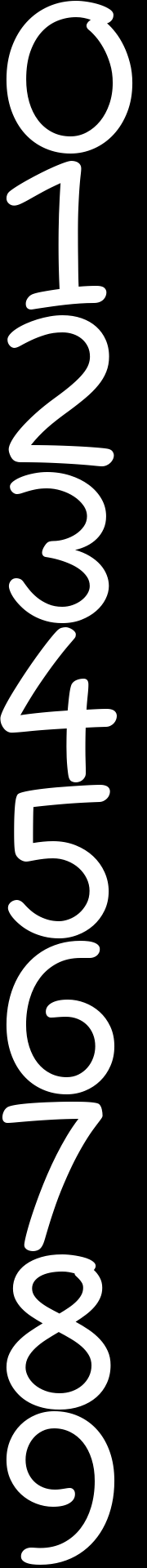

This also generates images though: This image has exactly what should be in the font, it is one composed image of ten images with 180x192 resolution.
Now lets convert this image.
Funtype_255_180x1920_L1.raw 44KiB
Funtype_255_180x1920_L2.raw 85KiB
Funtype_255_180x1920_L4.raw 169KiB
Funtype_255_180x1920_L8.raw 338KiB
Funtype_255_184x1920_COMPRESSED_RGBA_ASTC_8x8_KHR.raw 87KiB
Funtype_255_180x1920_COMPRESSED_RGBA_ASTC_10x5_KHR.raw 108KiB
That makes a lot more sense, I really wonder why the .glyph files are ten times the size of the actual images.
And how to use that?
Like this:
CLEAR(1, 1, 1)
CMD_SETBITMAP(0, L1, 180, 192)
BEGIN(BITMAPS)
CELL(0)
VERTEX2F(0, 0)
CELL(1)
VERTEX2F(2880, 0)
CELL(5)
VERTEX2F(5760, 0)
CMD_SETBITMAP(44160, COMPRESSED_RGBA_ASTC_8x8_KHR, 184, 192)
CELL(0)
VERTEX2F(0, 3200)
CELL(1)
VERTEX2F(2880, 3200)
CELL(5)
VERTEX2F(5760, 3200)
END()
I put this together in EVE Screen Editor.
And this is what this looks like: So I would definately go with the ASTC version.

So lets try that with NotoSans-Regular:
That is nicer in terms of evenly spaced width. The converted image is 140x1920.
NotoSans-Regular_255_ASTC_144x1920_COMPRESSED_RGBA_ASTC_8x8_KHR.raw 68Kib
So the converted image is a little wider to make it evenly divisible by 8.

I attempted to replicate your example and hey, at least I got a zero and half of a number 1 working, ha!
I created a font of size 510 which equated to each cell being 224x384. The size of the array is 19655. This font has the number 1 set far to the left in the cell but hopefully I can fix that later.
I don't fully understand how to calculate the memory-map defines and I believe that might be part of the issue. I can modify the value for MEM_BIGFONT value and I get less of the number 1 displayed but I don't know how to increase it or modify it correctly.
Hoping you can point me in the right direction. I'm reading the manual but this is all new territory for me! Thank you!
EVE_cmd_dl(DL_COLOR_RGB | WHITE);
EVE_cmd_dl(DL_BEGIN | EVE_BITMAPS);
EVE_cmd_setbitmap(MEM_BIGFONT, EVE_COMPRESSED_RGBA_ASTC_8x8_KHR, 224, 384);
EVE_cmd_dl(CELL(0));
EVE_cmd_dl(VERTEX2F(50, 100));
EVE_cmd_dl(CELL(1));
EVE_cmd_dl(VERTEX2F(290, 100));
EVE_cmd_dl(CELL(2));
EVE_cmd_dl(VERTEX2F(530, 100));
EVE_cmd_dl(DL_END);
/* memory-map defines */
#define MEM_FONT 0x000f6000
#define MEM_BIGFONT 0x000f8000 /* start-address of logo, needs 6272 bytes of memory */
