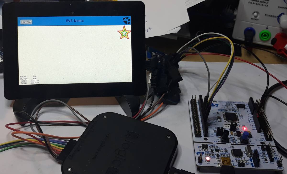

after struggeling with it for a couple of days I just pushed an update for my EVE code library that adds using DMA for the ARDUINO_NUCLEO_F446RE target.
SPI and DMA are using STM32Cube HAL and LL libs.
https://github.com/RudolphRiedel/FT800-FT813
An example that can be compiled with PlatformIO for a handfull of Arduino boards is here:
https://github.com/RudolphRiedel/FT800- ... PlatformIO
The STM32F446RE variant for the Nucleo-64 is using SPI1. Also CS and PDN are using the same pins as the UNO, the ESP32 or the Metro-M4 version.
In the picture, "Time1" with 12µs is the time for a display-refresh using DMA.
And "Time2" is for three commands without DMA, checking if EVE is busy, reading the length of the last generated display-list to be display as "DL-size" for debugging purposes and reading the touch-tag register, so these 18µs are static and do not grow with a larger display list.
Next on the list is a demo version for the STM32 without Arduino.
I never used STM32 for anything, do not plan to do so and I only have this one Nucleo Board here right now,
so please forgive me when this is not directly supporting whatever board you are using. :-)
Have fun, Rudolph
