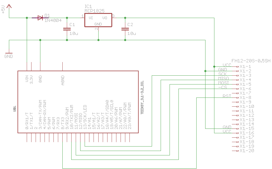

Here's the schematic of my setup:
DC power at 5V comes in through the USB on the Teensy. Even though the Teensy can supply 3.3V from its on-board regulator, the 200 mA+ the display is likely to draw is pushing its capability, so that's why the additional regulator. The Teensy and its signal lines are all 3.3V.
The 20-pin connector on the right obviously is the FPC connector for the 3" long cable to the display. The diode is just insurance.

Hi Paul,
Your setup looks correct. That said, there could be other factors of your setup which may be affecting the display's operation. During testing here, we found that the FT81x is very stingy about how our traces were routed.
