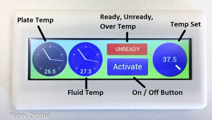

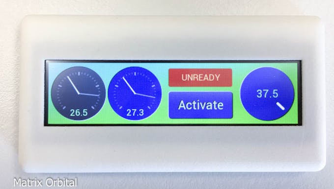

User Interface
User Interface
- Plate Temp: Temperature of the warming plate, blue dial when cold, red dial when warm
- Fluid Temp: Temperature of the fluid
- Ready, Unready, Over Temp: Status of the system
- Activate: the On/Off button for the system
- Temp Set: Dial to set the temperature of the Warming Plate

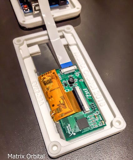

Display Mounting
We used the Matrix Orbital designed Front Panel TFT Mount for the EVE2-38A SPI TFT and had it printed at Shape Ways.
3D Printed Panel Mount and EVE2-38A 1U SPI TFT mounted

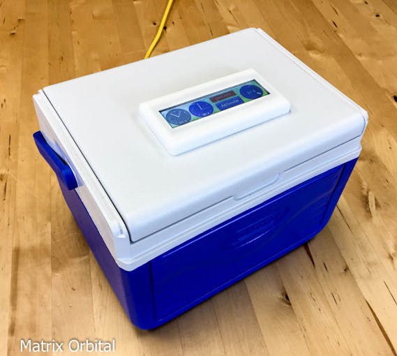

You will obviously need something to build the Warmer into and we chose a 6-pack cooler. It was a bad choice.
Sub-Q Warmer version 1.0
A control system is always easier to implement if it is inefficient and wasteful. This is the reason most ovens have a big hole in the top under one of the stove elements. In order to come to temperature quickly, you want to be able to put a lot of energy into the system quickly and that takes much more power than it needs to maintain temperature. An oven maker uses that high power to bring the temperature up fast, but then the temperature overshoots the users setting. In the case of an oven with that hole in the top, the excess heat escapes constantly through the hole and so overshoot is quickly dealt with.
We chose a cooler with insulation because it was the only thing we could think of at the time with hard and straight sides with a lid on top and a handle. We should have used an ammunition box and there is some intention to do just that in the next prototype if we make it.
In any case, this prototype works best with the lid open

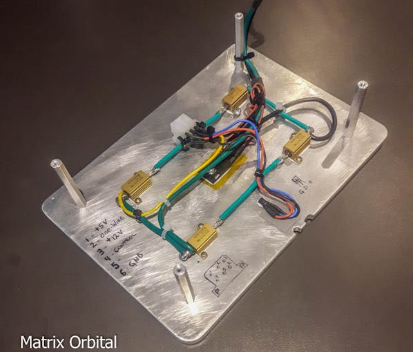

The Heating Plate
We chose a really heavy plate since we were concerned that there might be hot spots. We went a bit overboard. The plate in our prototype is 1/4 inch aluminum plate which we acquired from Metal Supermarket. The dimensions are about 22 x 15 cm and cost us about $16 Canadian dollars (or about $12 USD).
If we make another prototype in the future, we will instead choose a plate half that thickness. Any less than 1/8 inch is going to make mounting holes difficult to thread. 1/8 inch is still stable enough to provide the structural strength we need without adding so much thermal mass to the system. The control loop will work better without all that mass.
The heating elements are made from high power resistors mounted to the backside of the plate with screws and heatsink compound. Power control is achieved with a large transistor mounted on the plate along with the heating elements. It is going to get hot anyway, so why not use it's waste heat to help do our job for us?
The specific transistor is a TIP140 in an encapsulated package to simplify mounting. Mounting is achieved with the use of a screw into a threaded hole and kapton tape as an insulator. If that is too ghetto for you, you can buy mica insulators for pennies.

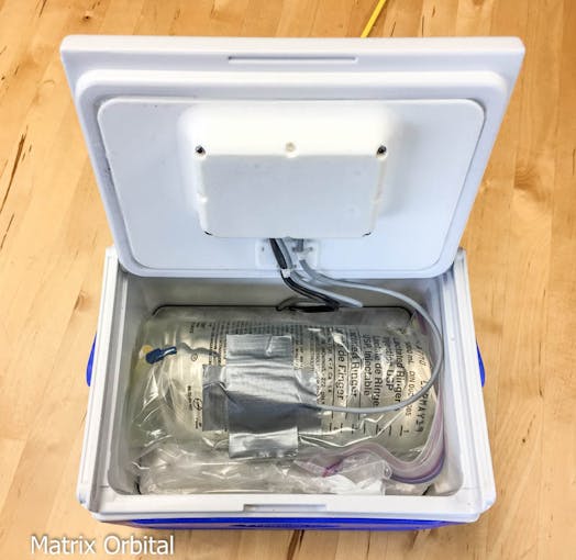

Place the bag of solution into a large freezer ziplock bag between use and leave it in this bag during heating.
The Subcutaneous Fluid being heated
The temperature probe must be applied to the bag in a place where it will be in contact with solution instead of an air bubble in the bag - on the top to one edge. Apply the probe with a piece of white foam double-sided sticky tape or a piece of duck tape with piece of foam in the middle to act as an insulator. You want to be measuring the temperature of the bag - not the environment.
As mentioned elsewhere, the lid of the "warmer" should be left open. This is especially important if you intend to come back "later" instead of waiting for the announcement of readiness. The system tends to overshoot the set temperature a bit and that is hard to prevent given the differences in loading (how much fluid is left) and ambient temperature. Leaving the lid open allows it to cool back to the set temperature.
When the temperature reaches the set temperature, an alarm will begin to bing every 5 seconds and the ready indicator will change to green. If after some time, if the temperature rises more than a degree over the set temperature, the bing will change to something more alarming and the ready indicator changes back to red.
