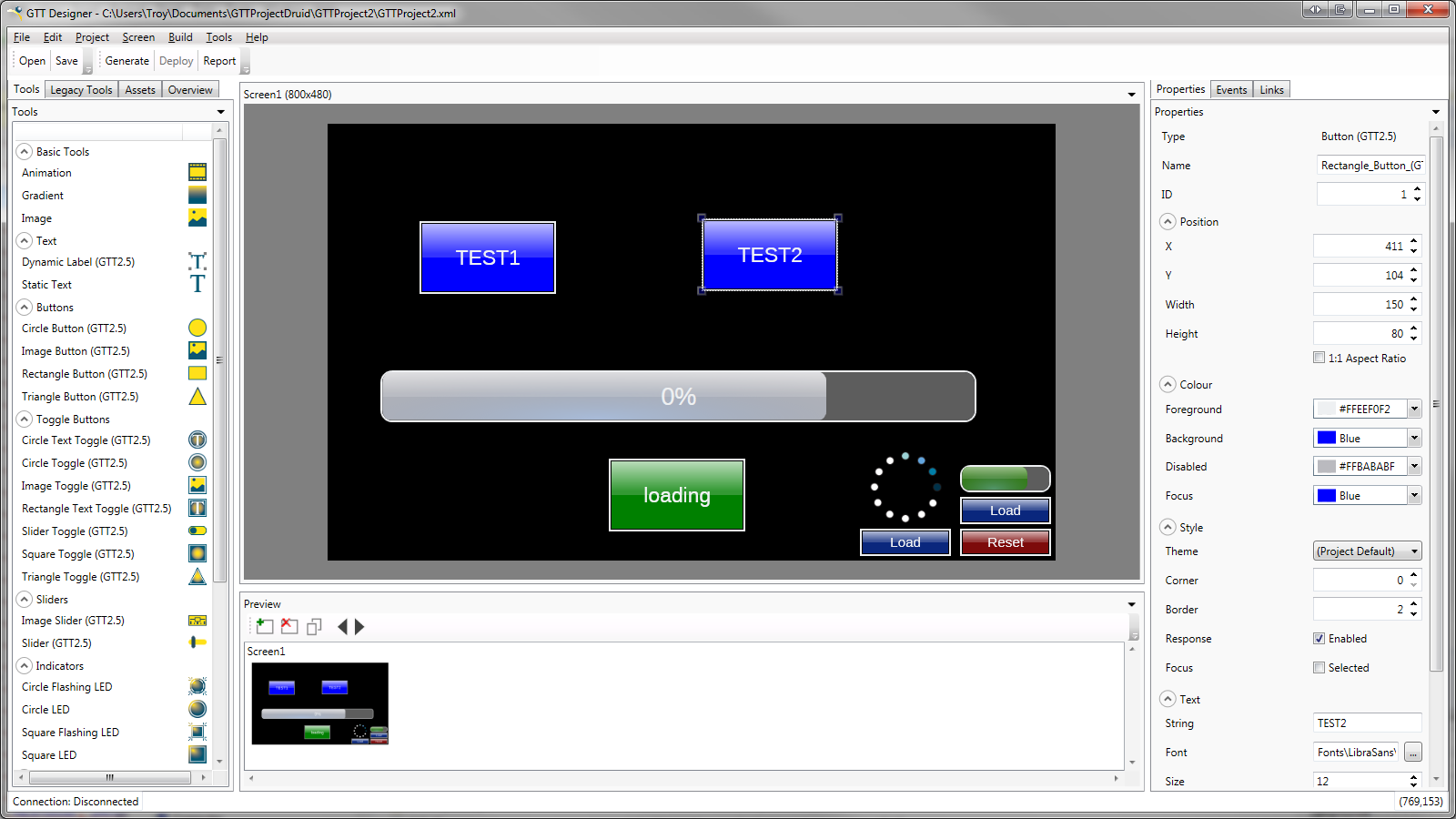

Hello Clark,
I sent you a mini project =) two buttons of different styles. Am I correct for events? With the flicker of the screen I managed ... I need to make the brightness of 0 before processing the shape change event, and after the event processing make a delay of 500 ms and make the brightness with a value of more than 200.
In the output file Report.txt there is no information about changing the text of the button.

Forgot the slider ... look at the mail

Hello Druid,
I appreciate the project you've forwarded and see you are exploring some of the basic Designer features. We'll certainly take your general feedback into consideration for future releases, and I can help you solve some of the specific issues you've noted below.
  • I see you have a custom script attached to the up event of a GTT2.5 style button to change the text of that button from TEST2 to OK_2. I can confirm that the text, as well as the colour change you have implemented in your custom script are working well. With regard to the background colour, that button is using an image for it's background so that command is not producing a visible effect. I can certainly help you create the functionality you need here. What function do you have in mind for this button?
  • I understand you have solved your flicker/glare issue by dimming the screen. This is a good workaround, but if you would like please feel free to send a short video of the effect and I can dig into the issue further. Sometimes flicker can be caused by insufficient power, especially with our 7.0" unit, which draws more backlight current than any other.
  • Yes, when our bargraph was update to the GTT2.5 style we smoothed visual updates to that object by executing property changes from scripts only at completion. Unfortunately, when simulating loading updates from a custom script, the GTT2.5 style bargraph will only respond visually to the last update, after script execution is complete. This behaviour won't affect updates in real time, but we're investigating a way to bring back this bug turned feature to the GTT2.5 style object. For our simulation, you might try the legacy bargraph or an animation, as I've added to the corner of your demo below.
Finally, I can confirm that information regarding changing the text property of GTT2.5 style buttons will be added to the Report.txt file in our next release. Again, we have an update scheduled for either the end of this week or the beginning of next.

My apologies for the delay, you can now find a Designer update here.
We've added more loading options to the Settings window, which will allow you to pre-load your bitmaps and should alleviate some of the screen flickering you've noted. We have one more update planned to enable pre-loading of nine-slice images for objects like sliders which will offer even more improvement.
We've also added property and method information to the Report file that outlines how to change the text of a GTT2.5 style button.
