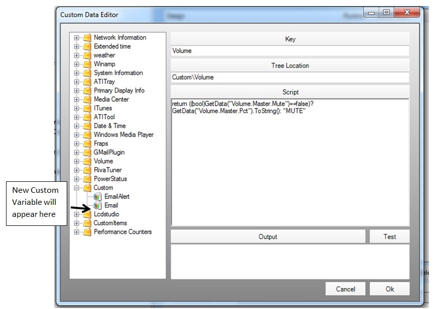

First, go to the "Data View" tab in LcdStudio. You can right click in the area and the option saying "Add Custom Variable" should pop up. Here, under "Tree location", you can provide the name of the new Tree that will be available on the left hand side. The "Key" is used to reference the custom variable in the design files. Once your "Tree" and "Key" have been written, you can press "Ok". A new window will open up allowing you to write your own code and drag and drop data items.
Custom Data Editor.jpg (102.79 KiB) Viewed 29577 times
The next step is to get the email data. First, select the data you want to display. This could either be the last message author, or the time you received your newest email, etc. Attaining the data is simple. All you have to do is select the data from the data tree, and drag it into the script window. For example, to attain the last message time data, you simply open open up the GmailPlugin in the data tree. Then you click and drag the “LastMsgTime” into the scripting area. Get data code will be generated for you once this is done. You can use the “Test” button to see what will be returned. Once this is done, you can change the key name, and the tree location. You can then drag this new custom item to your display and the message time of your newest email will be displayed on screen.
