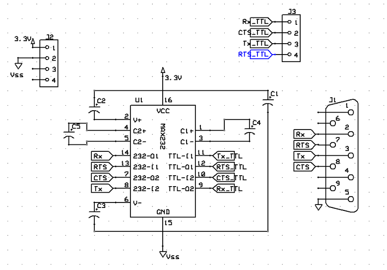

Hi all,
I see that the module in rs232 ttl mode works with 0-5V
Does is also work with 3.3V signals?
If not, i will choose for a rs232 with a max2323e (3.3V)
Does the following schematic work with the module? or do i need more pins from the db9 socket.
Luc
Luc
- rs232tottl.png (71.93 KiB) Viewed 10255 times
Hi Luc,
The LPC2468 datasheet for the controller used specifies a minimum input logic high voltage of 2.0V, I expect the GTT will receive 3.3V signal levels correctly. Please note the unit may output levels up to the voltage powering it, make sure your signalling circuitry can handle at least 5V.
