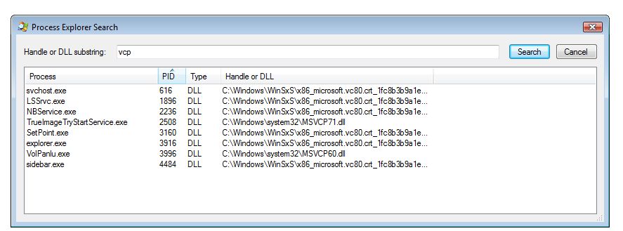

By the looks of it some application is keeping the port in use, grab a copy of Process explorer from microsoft and see if you can figure out who's using it. (use "Find handle or dll" and search for com27 or VCP but be sure to only watch for handles if you search for VCP)

I cannot find com27 but I do find vcp as per attached screenshot.. What do I do now ? Not sure what you mean by "watch for handles"
Weird, never seen anything like that, how did you end up with 27 com ports?
