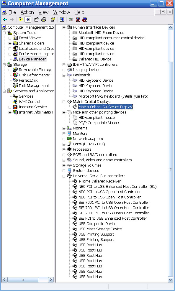

I received my GX today, thank you! However it didn't come with any software, so I downloaded Microsoft .NET 2.0, Driver Core 58 and LCDStudio from the Internet.
I did not find any front panel support for MCE. Is it released? How do I access it?
And also my GX IR sensor doesn't work properly. I unplugged my Microsoft receiver, installed GX drivers, plugged GX, the devices are recognized in the device manager (see the attached picture), but there is no response from the remote control in MCE shell, only the blue LED is blinking. The remote itself is fine as it works with Microsoft receiver, and the batteries are fresh. Otherwise the display is working, and my firmware version is 1.07. When I plug my Microsoft receiver, the remote still doesn't respond unless I totally unplug GX. I tried to reinstall the drivers, used a different USB port, same thing. I understand you cannog guarantee they can work both at same time, but GX receiver doesn't work even solo. So my remote control is totally disabled now. Please help!
gx problems.jpg (197.22 KiB) Viewed 17406 times
The IR part we are going to have to look into. The MCE application is LCdInfo.exe which should be added to your startup menu at installation time. There are no settings to be made for it so it does not have a gui.
