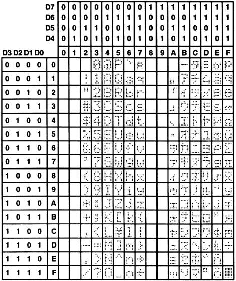

Hello Paul,
I am certain now that the LK204-25 you have has been programmed for a PK204-25 display. Do you have only 1 of these displays (LK204-25 LCD displays that return a 0x4D when queried for its module type)? I would like to get it back here for reprogramming.
We used to have the Japanese character set on our alphanumeric displays before and we have moved to the European character set now. When you see a full block for 0xFF (255), this means that the character set is Japanese. Attached here is the Japanese character. I hope this explains the issues regarding some characters (arrow, etc).
Yes, please verify and investigate some more on the issue of delays, I have not really had issues with alphanumerics before.
Also, if you need your display to be European, please specify when you send the display back.
- jap font.jpg (57.67 KiB) Viewed 7219 times
