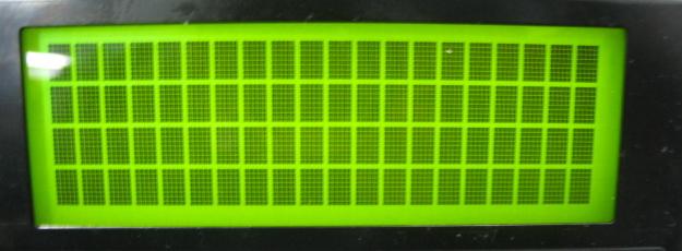

Hi All,
I am using LCD2041 Rev2.0 display. It was working fine till yesterday when suddenly it stopped responding to I2C commands. I power cycled it and it started displaying Blanks (Earlier "Matrix Orbital" logo used to display). I tried RS232 communication but its not responding. It responds to RS232 only when J0 jumper is installed (reset to factory defaults).
After going through the manual, I tried reseting it to factory defaults by closing J0. But when J0 is closed it displays garbage.
Any clue what is going on?

- Factory defualts.JPG (15.51 KiB) Viewed 5995 times
- power-up.JPG (24.49 KiB) Viewed 5995 times

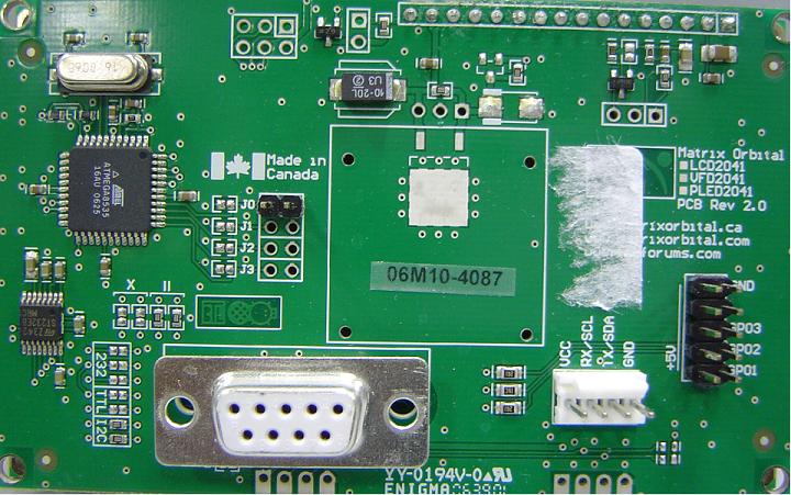

First off, I can see that you probably meant LCD2041 instead of VFD2041. It sounds that somehow maybe the module has been configured differently (unintentionally). With the manual override jump on, keep the mode on RS232, use uProject to communicate with the module.
Can you please send me a picture of the back of the module?

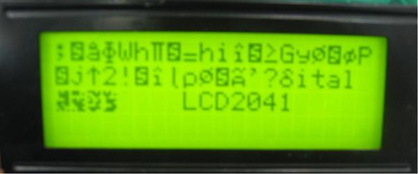

Thanks Raquel,
The main problem was that the contrast was set to 255 due to which blanks were appearing. Secondly the unit was programmed to invalid I2C address and baud rate was invalid.
I am now able to communicate to unit through I2C and serial.
However the text now appears tp be garbage in between. The scrolls are incorrect and lines end with special characters.
Kindly suggest how should I get a correct display.

Hi Nitin,
You mentioned before that this module was working fine. I have not seen a case where the built in fonts are corrupted. Do you use any characters other than alphanumeric (A-Z, a-z, 0-9), say an arrow sign or something?
Also, when you first power the display up, does it show its normal start up screen? Can you turn the backlight on and off using I2C?
