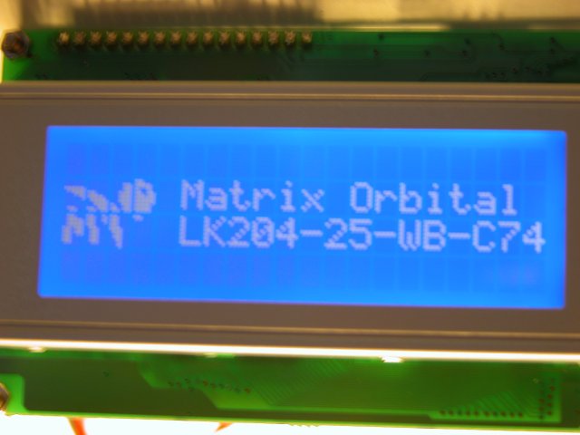

We've got over 4 dozen of the LK204-25 Matrix Orbital Displays that we are using with a micro (hooked up with the I2C) and a keypad. Over time some displays (approx 2 dozen) have been locking up....and after they lock up....the next time you power it off then on, it gets locked up at the Bootup screen. Are these displays damaged or is there a way we can fix them or replace one or two components to fix them?

No I am not able to communicate.....it stays at the Matrix Orbital Screen. Could the RS232 chip taken a hit or the programming for the display?

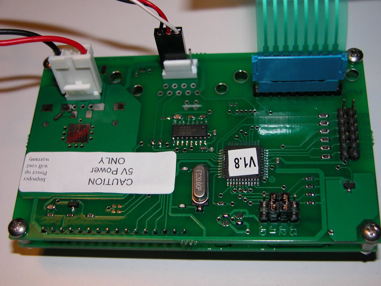

How do I switch the Display to RS232? I have the RS232 signal connected to the lower middle white 4 pin connector.
Thx
Is it possible for you to post a picture of your module? What is the PCB rev?
erv100
Posts: 6
Joined: Wed May 31, 2006 1:02 pm
Post by erv100 »
Here we go, The pics are attached. The Rev is 1.23
Erv

I try again. The Pics must have been to big. (2 Pics total).
