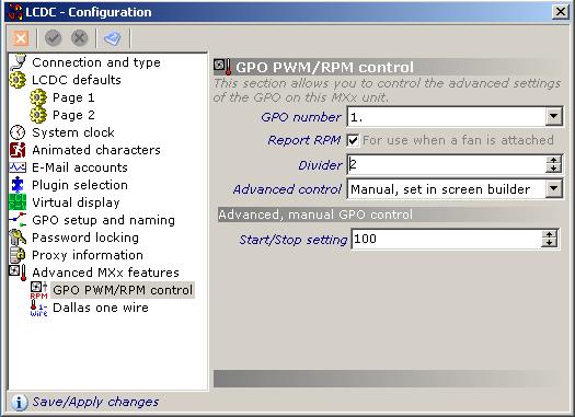

I'm just learning how to use this but when I select "Start Display" all my fans immediately turn off. Why does it do this and how do I make it stop?
Hi LCD user,
Thanks for posting on the forum.
The reason why your fans turn off because you don't have the fan options set up, so the fan will start at 100%.
I have attached a picture on how the configuration should be onr LCDC below.

I've had everything set for the fans just like you told me. It was working but now it turns them off again as if it reset itself. It has the same settings though. ?
What have you set in screen builder?

What happens when you program an event, so that on LCDC startup, the fans turn on?
