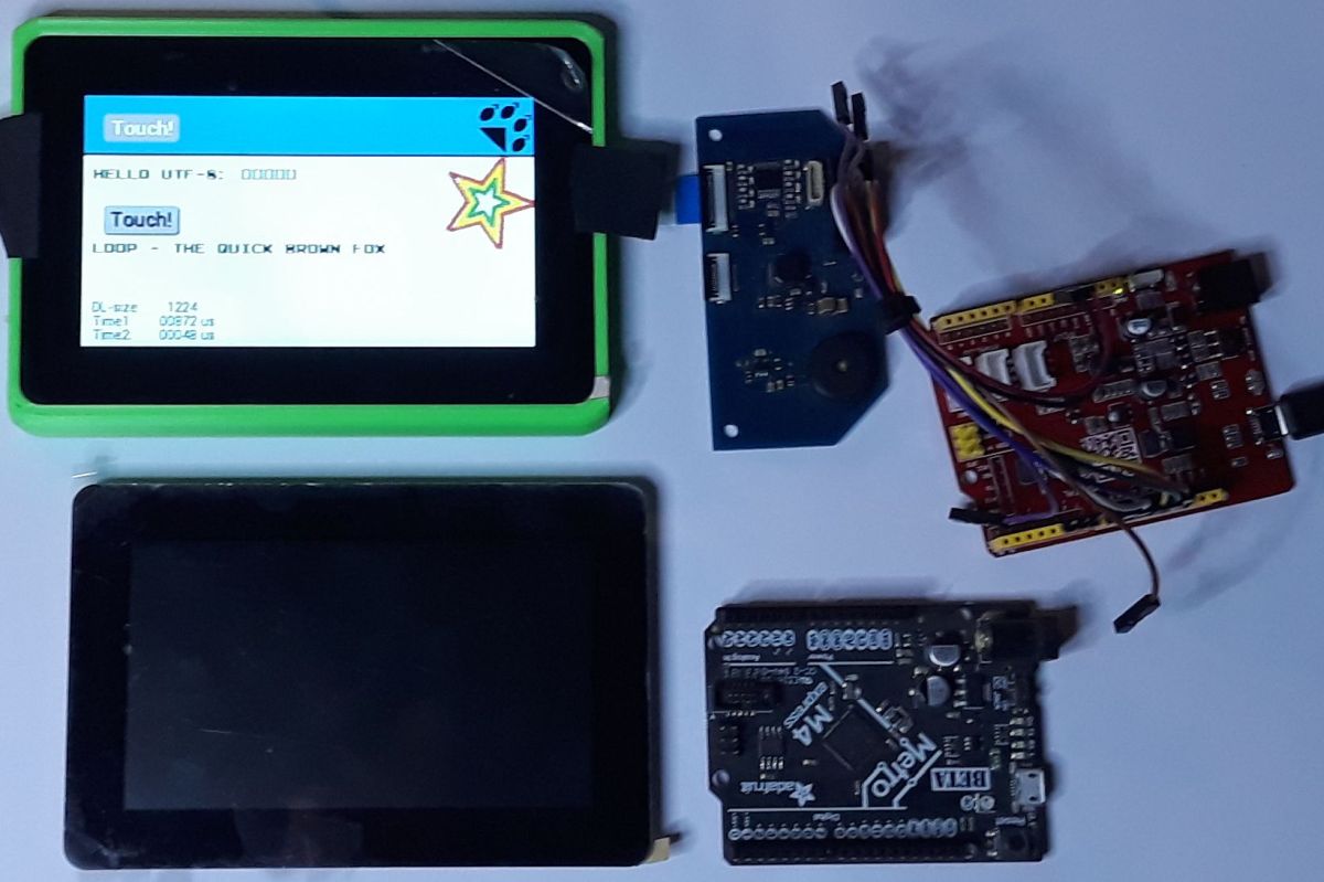

Okay, this is the same project but it has Arcade_R:
EVE_Test_Arduino_PlatformIO_EVE3-43G_UTF-8.zip
(84.82 KiB) Downloaded 402 times
The difference is that for some reason I had to place the "Loop..." text line a little lower.
And the "Hello UTF-8: €µäöü" line is all upper-case now and has no special chars at the end, only empty squares.
The font is not one I would pick or only for a very specific reason. ;-)

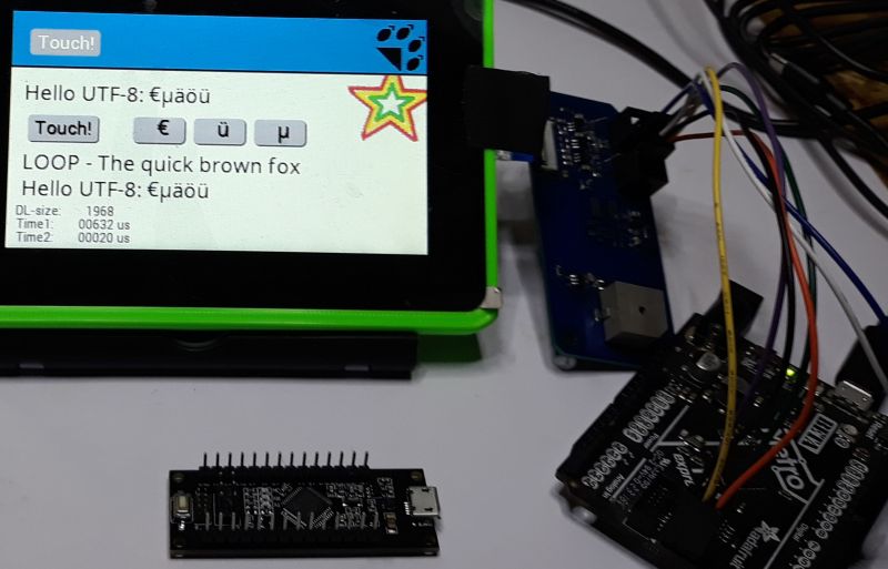

I briefly swithed over to my Unicorn and it worked right away except for the touch,
when I switched the configuration in EVE_config.h I also got touch support.
Now, I do not have an Arduino M0 and do not really want one. :-)
I tried to use a Metro M4 that is collecting dust here for some time now.
But I can't get it to work right now, the software builds, gets flashed, the screen stays black.
Maybe some library issue, no idea.

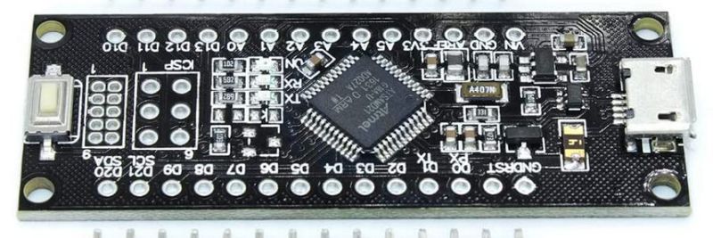

Today I learned that the Metro M4 does not support SPI on the same header as the UNO, at least not directly out-of-the-box.
I'll try to use it with the hardware SPI from the ICSP header as it is intended to be used.
And I ordered one of these:
Just because I would like to know what the issue is.
You are using the Arduino framework with your Arduin M0?
I do prefer going bare-metal though. :-)
dood
Posts: 20
Joined: Fri Oct 30, 2020 5:10 pm
Re: Using Custom Fonts
Post by dood »
You never give up ! :)
Yes, I'm using the Arduino framework.
Mine is this one : https://robotdyn.com/samd21-m0.html (for testing purpose).
For my project, I'm buying SAMD21 chips and burn Arduino official bootloader on them with an Atmel ICE programmer.
I encountered freezes on these 2 boards but that's the same chip, same bootloader so that's pretty obvious.

Sure, I do give up as everyone else. :-)
Well, I have it up and running on my Metro M4 now.
I did not have to change anything, only wire it up correctly to the ICSP pins for SPI.
Yesterday I hooked up a Logic Analyzer to the Metro M4 and found that the default SPI speed is 4MHz.
And with "SPI.setClockDivider(SPI_CLOCK_DIV2);" it is 8MHz.
So this probably is setup the same way as the Arduino core for ESP, with dedicated values for the SPI clock
and redefining what "SPI_CLOCK_DIV2" and so on means in order to get the same speed as it would run on an Arduino Uno.
What was really frustrating me yesterday was that the upload from PlatformIO to the board only worked once.
When I uploaded something from the Arduino IDE, like the blink example I could upload with PlatformIO again - once.
That really was a showstopper.
I dug in and manually replaced the version 1.9.0 of bossac.exe in \.platformio\packages\tool-bossac with
version 1.9.1 from here: https://github.com/shumatech/BOSSA
And now it just works.
I would like to report this somewhere so it gets updated for everyone else but I do not have the slightest idea who is
responsible for the integration of this package into PlatformIO.
Anyways, when I compile with PlatformIO it uses same GCC V7 and in the Arduino IDE I saw 4.8.something.
Adding support for Arduino Zero/M0 was not enough, I am updating "Adafruit SAMD Boards to 1.6.4" now.
Oh, it uses GCC9 now: 9-2019q4
And it just works even when compiled with the Arduino IDE.
I do have the SAMD21 board as well now but it really should not make any difference.
For Arduino this is all using the same code on my side anyways calling SPI.transfer() and digitalWrite().
So as long as the Arduino cores work it should make no difference whatsoever if this is used with an Uno, a Zero, a Metro M4, an ESP, STM32 or whatnot.
But to actually use this D21 board is something different, looks like the "M0" is not really an Arduino, the M0-mini never was one and if the schematic for the board is correct it is anything but not compatible with an M0.
I can only hope that the schematic is wrong but this does not help much. :-)
If there is something to make it crash and burn I have not triggered it yet.

Rudolph wrote: Fri Nov 06, 2020 12:39 pm looks like the "M0" is not really an Arduino, the M0-mini never was one and if the schematic for the board is correct it is anything but not compatible with an M0.
You talk about the mini-M0 you just recieve ?
Because my M0's are Arduino, I'm using "Arduino M0" in "Arduino SAMD boards" and everything is fine.
I can try with an M4 but don't actually have one and won't use it anyway so a little bit useless ... except to know the truth :)

Yes, I am a tad bit sceptic about the mini-M0 I received.
It probably is even working fine - after figuring out which bootloader it uses and what Arduino Core to really use with it.
But I could not find documentation for it, it maybe is a knockoff from the RobotDyn design.
The M4 in this regard really is only annother Arduino with an even higher core clock and more memory.
