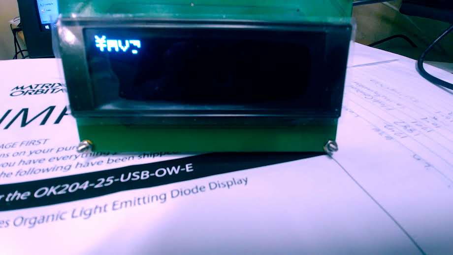

I just picked up my first character display and I'm having a few issues displaying characters on it. So first off, using the hello, world sample code it is working mostly fine. I get a weird character at the very end of the string that I didn't enter. attached photo helloworldchar.jpg

however, the text on the display doesn't make sense. check image texterror.jpg

This is obviously an issue with my c++ abilities, as if I create an new message from within the writeToDisplay() function it works just fine. Its something to do with how I'm passing the value to the function. I just can't seem to figure it out.
write to display garble.
Hello Wold Weird Character

I've taken a look at your first photo (helloworldchar.jpg) and it looks like your string's NULL terminator (0x00) is also being sent and displayed on screen. Sending the Hello World string without the following NULL terminator should get rid of that extraneous character on your screen.
It looks like the issue highlighted in your second image is being caused by a mismatched baud rate. What baud rate is your port set to, and does it match your OK204-25's baud rate?

Hey thanks for the welcome! I appreciate your time. So I'm not sure how to remove the NULL terminator. I've worked with serial communications awhile back and remember that there might be a way to ignore that by making changes to the port_attributes. I'll have to dig into that a bit more. For now I just de-incremented the sizeof value by 1. This eliminated the null terminator.
So the garbled message. I'm using the same baudrate for each of my program, 19200. Bytesize = 8, no parity, and one stop bit. I literally just copied and pasted these settings. All other commands, change cursor position, blinker on off, underline on off, and etc is all just fine. Here's a sample that works and doesn't work at in the same program.

void Character_Display::writeToDisplay (unsigned char mesg1[])
	unsigned char mesg2[] = "Test 2";
	WriteFile (my_port, &mesg1, sizeof (mesg1)-1, &bytes_written, NULL);  // this line won't work, see picture below.
	setCursorPosition (1, 2);
	WriteFile (my_port, &mesg2, sizeof (mesg2)-1, &bytes_written, NULL);  // this line will work just fine.
line 1 garble, line 2 clean

So I've resolved the issue and I was correct it had to do with my inexperience with c++. I changed the incoming parameters associated with my function. I've included a pointer to the first character in the array and the the size of the array. This allowed me to use the pointer and the size to pass the text to the display and worked just the way I needed it to.
Character_Display cd = Character_Display;
unsigned char message[] = "Testing 1";
unsigned char * ptr = &message[0];
cd.ClearScreen ();
cd.writeToDisplay (&message[0], sizeof(message));
void Character_Display::writeToDisplay (unsigned char* ptr, int size)
	WriteFile (my_port, ptr, size-1, &bytes_written, NULL);  // this line won't work, see picture below.
