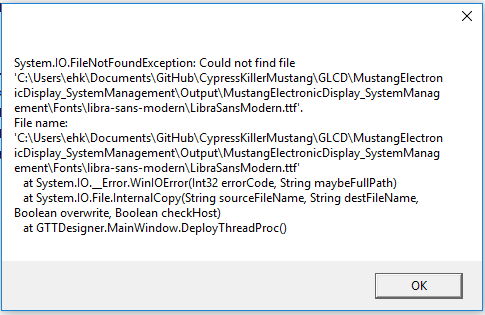

I am trying to deploy, and have a custom font, but the software keeps throwing an error for the standard font. How can i resolve this?
The messages get up in order as I have shown here.

According to the error messages, the GTT Designer cannot find the specified files/paths.
The first error states that the Designer can't find the LibraSansModern.ttf font at the path specified.
There are two solutions that I can suggest:
- You can change the font on all of the objects that use libra-sans-modern\LibraSansModern.ttf font
- You can navigate to your project's font folder (C:\Users\ehk\Documents\GitHub\CypressKillerMustang\GLCD\MustangElectronicDisplay_SystemManagement\Assets\Fonts) and drop a copy of the LibraSansModern.ttf font in the libra-sans-modern folder.

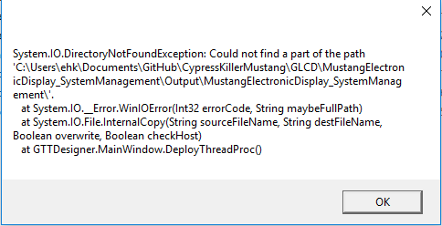

I haven't been able to replicate your second error. Is it possible for you to email me you project so that I can test it here to figure out what might be causing the issue?
You can email your project to support@matrixorbital.ca

I was able to fix the first one as you stated. I will send my project to the email provided for any help you can give me on the second one.

I received your project and we're currently looking into what might be causing the issue!
Re: Error Deploying
Hi Haz,
We were able to take a look at your project, and we found that two of your labels were not using valid fonts, and their font fields were left blank. Please try pointing to a valid font. That should allow you to deploy your project without receiving any unwanted errors messages.

I just went through my project and found where the font was blank.
