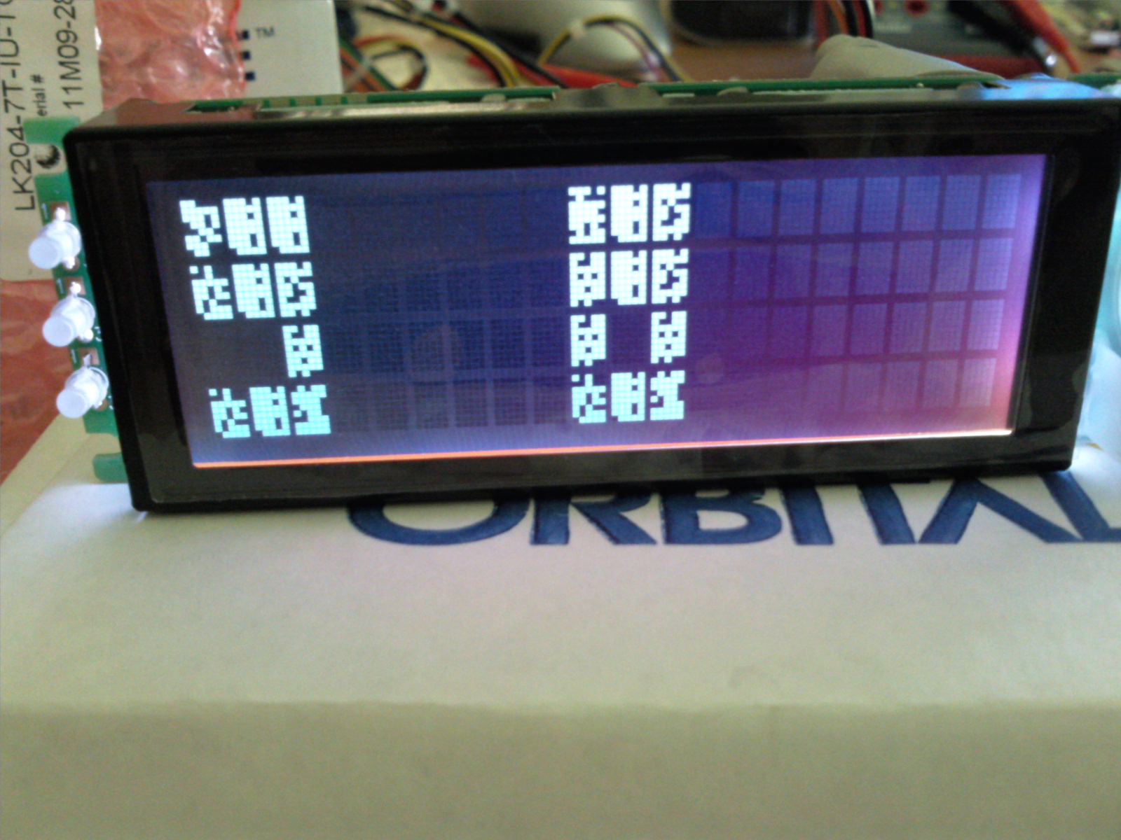

One more thing. A while ago I reported that the bar graphs wouldn't show up properly.
In uProject I did a large digit test: I placed a "5" and a "6".
The result is in the attached picture, which isn't a great result at all.
Please, help me solve these issues or I will have to find another way.
- Foto0013[1].jpg (731.08 KiB) Viewed 8241 times
Hi Jon,
It sounds like communication in Windows is now failing as well. It's difficult to say what has happened to the unit at this time, but without the ability to communicate to the unit it looks like I'll need to get it back for repair.
I see the start of the serial number written on the box in your image, if you could confirm the entire 11M09 number listed on the box as well as your shipping information I can get started on an RMA order for return.
Please send all information directly to me through a PM.
~Troy
