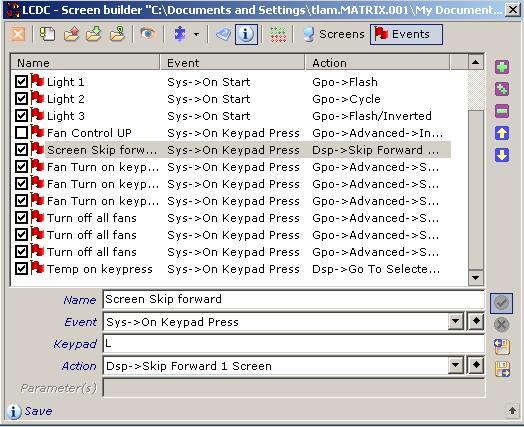

4) i want to connect 2 buttons to the keypad connectors on orb 232 (4 wires tolal so i can pause a display (or orb) and advance foward.
how do i hook up 2 wire button(x2) and how do i program lcdc to do what i want..

4) First off you will want to refer to section 3 "Keypad Interface" page 16 in the manual at http://www.matrixorbital.ca/manuals/LK_ ... SB_140.pdf This will tell you a little bit about the keypad connector. What you will need to understand is the keypad connector consist of a 6 column 4 row matrix. There is a table in the manual that tells you which row and column corresponds to which character. When you short a row and column, it will generate that specific character. You will need to hook up one end of the button to a row and the other end to a column. You then need to program an event to what you want to do with the keypress. The picture below is an example of this feature. When you press the button, the screen skips forward.
