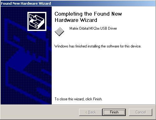

W2K
Windows 2000
Installation

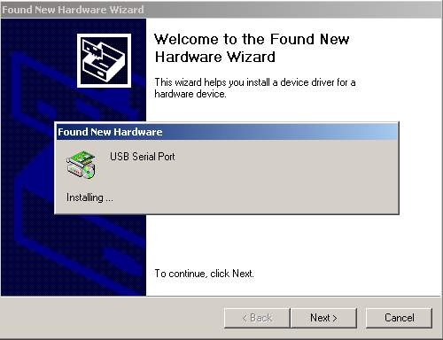

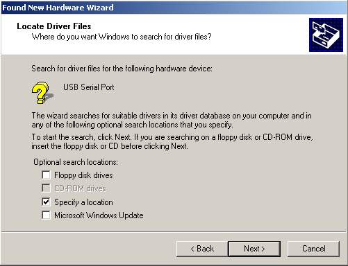

When the LCD is plugged in, Windows will detect new hardware.
The Windows Installation Wizard Loads to help with the install. Press next to continue

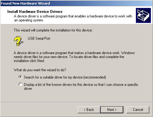

Select Search for a suitable driver for my device and press next.

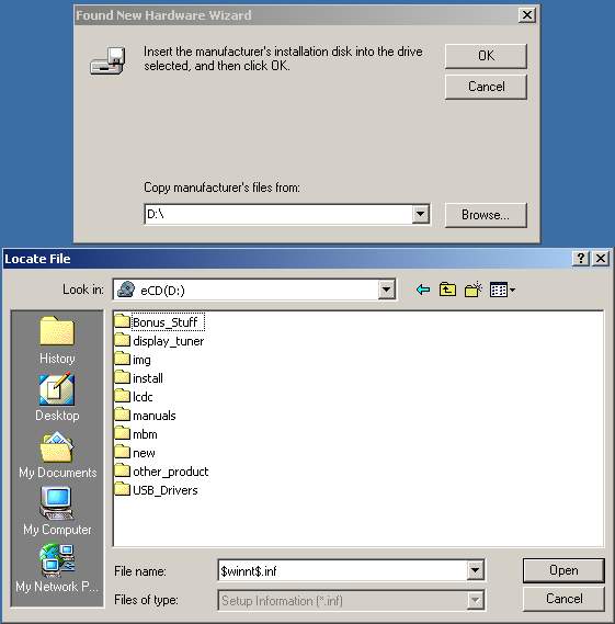

Specify a location.
Go to your CD-ROM drive, and to the directory USB_Drivers
Windows should find a correct info file. Press OK, then press next.
Part I of the install is now completed.

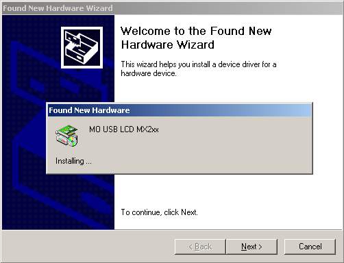

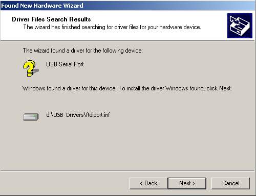

Windows will now detect a second new device.

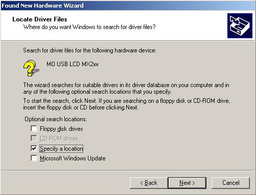

Once again, press Search for a suitable driver for my device and press next.

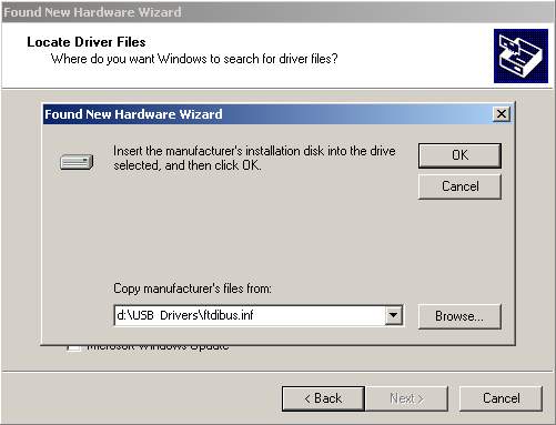

Like before, Specify a location.

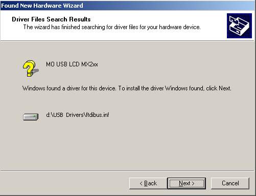

Point the Install Wizard to the correct directory.
Windows install will find a second info file, press OK and then next.

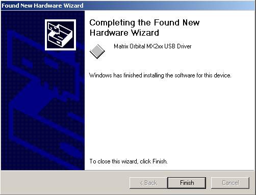

Installation of the drivers is now completed

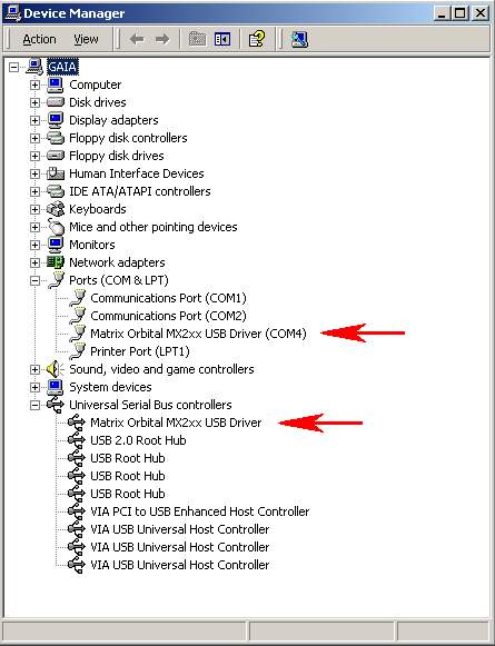

Lets double check that the device drivers were properly loaded by going into
the Control Panel/Hardware
Specify a location.
